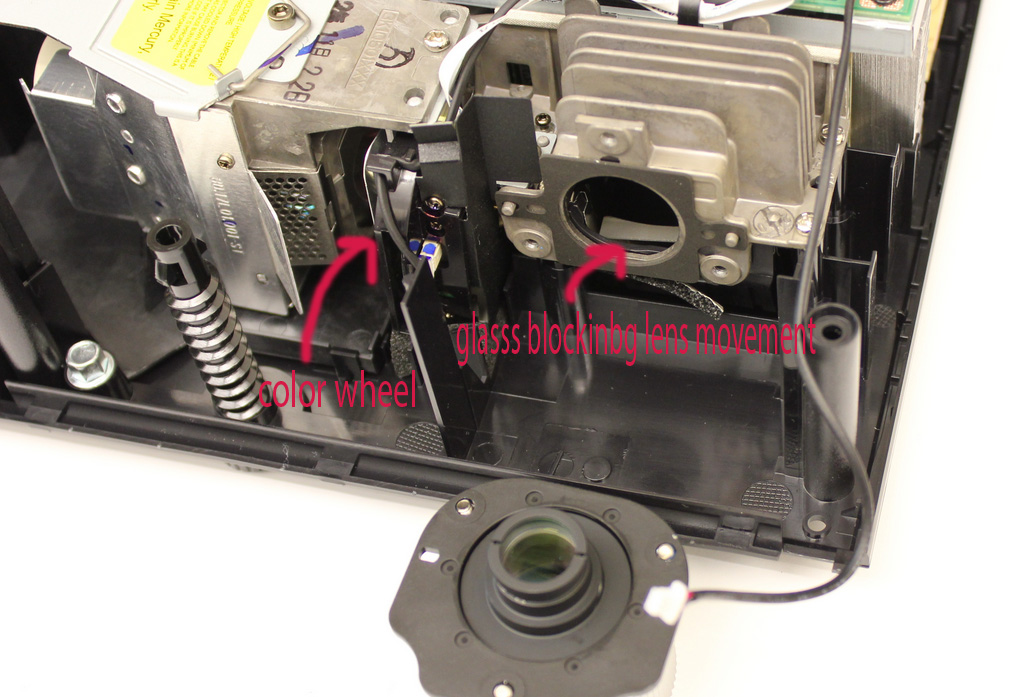

A few more questions, now that I'm understanding your method better.
What tools did you use to extend the holes by 3mm upwards? Is that lens assembly made of steel?
What size drill bit(s) did you use and did you have to use a drill press? Hand power drill?

no need to drill nothing, only put metal spacers, a nut, something 3 mm tall to wring out the lens assembly. maybe will be necessary get new longs screws. See this pdf. Diferent brand, but i think procedure will be very similar.

You must extend hole, not a spacer. This lens made of plastic. I used a micro motor and 3mm tool cutter.

I think I understand now. Thanks, Cihan!

someone tried to remove the color wheel ?? i know its not really necesary for cure resin, but without color wheel i can use in other preojects ( 3d scanning ).

Has anyone successfully opened the 6510? I tried for a few minutes but didn't feel like breaking it....

I don't think the focus issue is solved by moving the lens out but by moving it down (edit: put up at first). I'll give it a try tomorrow. Also how'd your sensor work out?
