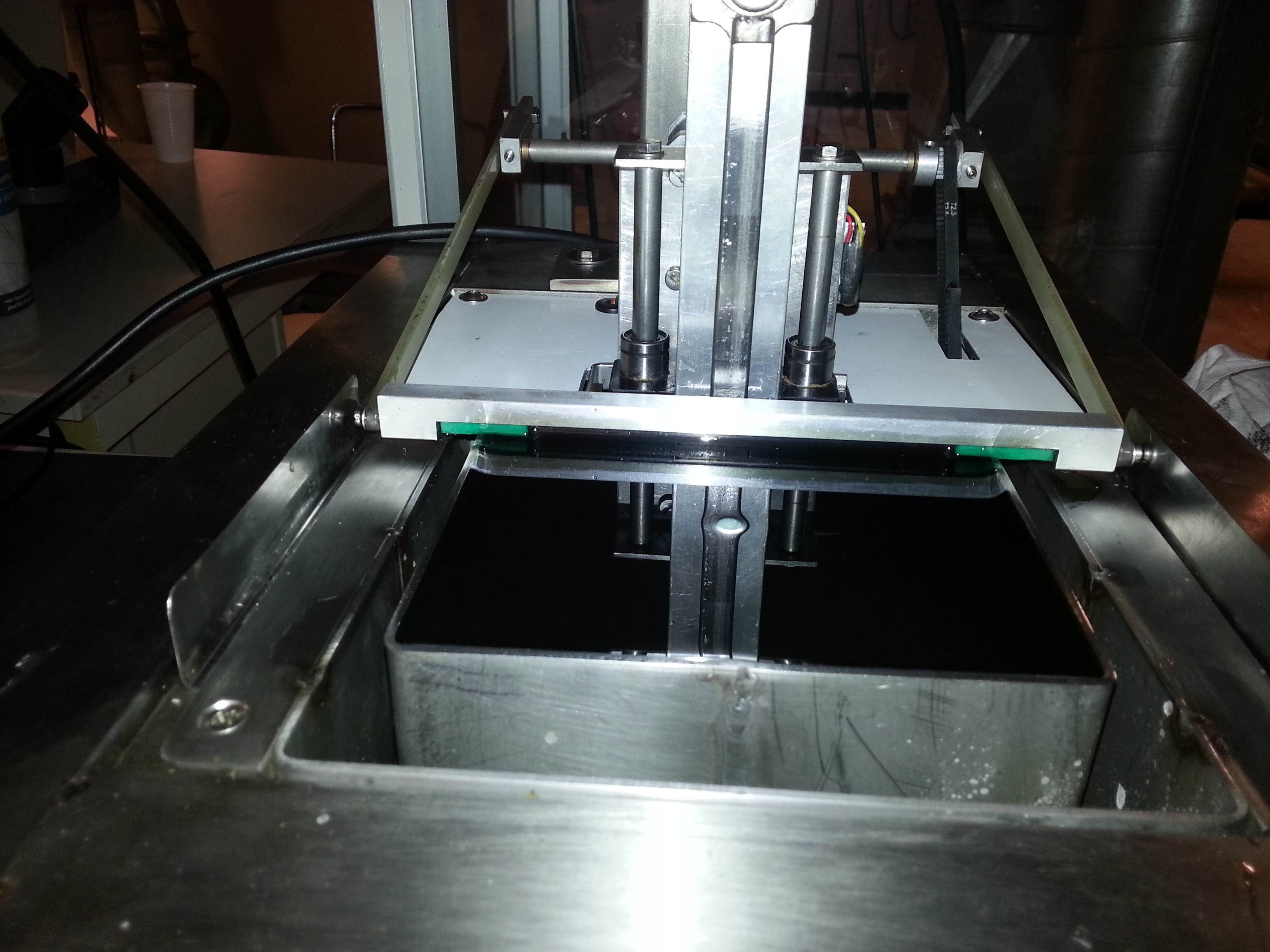

Re: "Bottom Up" versus "Top Down" Style of 3D Printer
I am using the top down system for a couple of months now with a inverted u as a wiper, the resin is cappilairy pulled into it and delivers resin to the lower areas that are created when the part is lowered 1 layer. Trick is to have the wiper not at resin level, but slightly above it , a few tenths of a millimeter. Best is to lower your object 0.05 mm more then a layer heigth and after wiping let it come up this 0.05 mm. Stabilisation time after this is 3 seconds.

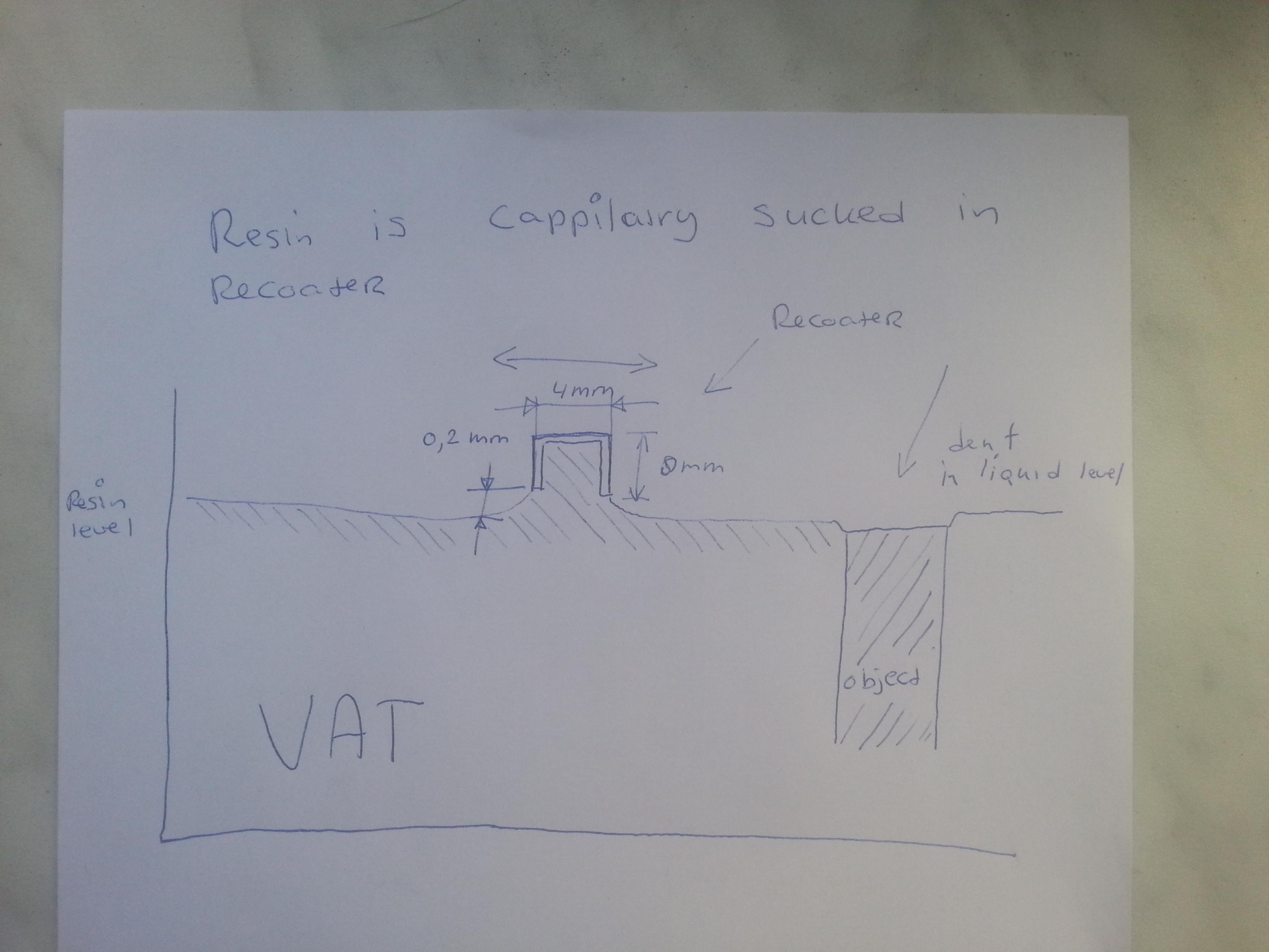

Hi, I made a quick drawing of what i mean by the inverted U, its metal with thin walls, as thin as possible, i made the walls from 0,3 mm steel. The wiper (recoater) is making a single forward or backward move after each illumination. This way the dent in the resin above the lowered object is filled from the resin supply in the inverted U. This idea is not mine, search for recoater in combination with sla. I hope i made it clear, if you have any question, feel free to ask.
