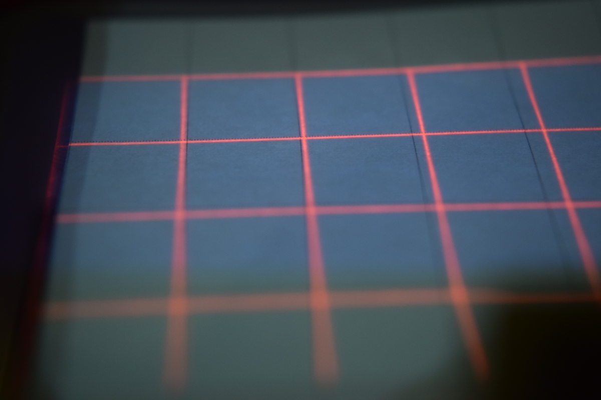

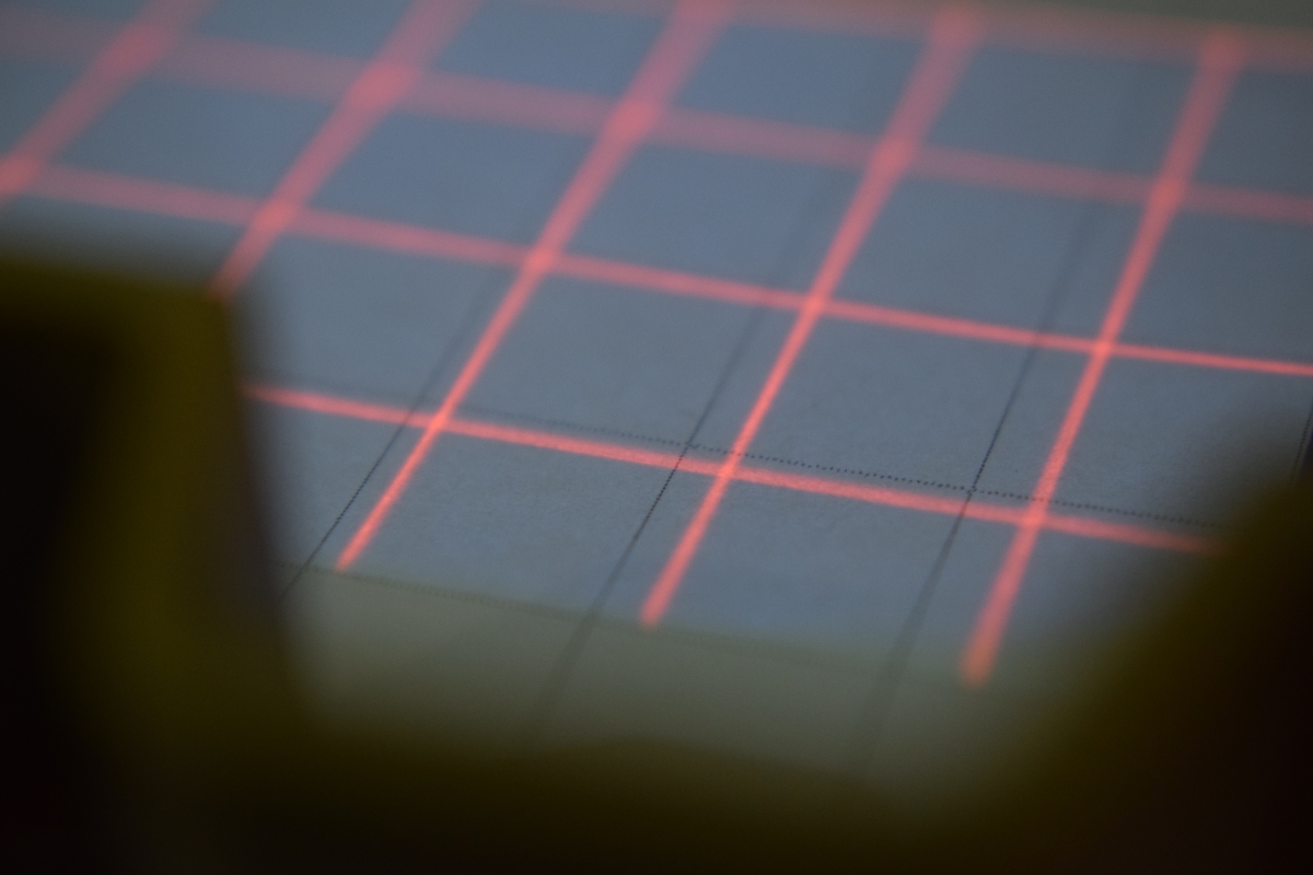

how can i solve this issue please?
Please help !
- Posts: 64
- Joined: Sat May 28, 2016 7:54 am [phpBB Debug] PHP Warning: in file [ROOT]/vendor/twig/twig/lib/Twig/Extension/Core.php on line 1266: count(): Parameter must be an array or an object that implements Countable
Re: Please help !
Are you asking about the different grid size between projection and calibration?
- Posts: 85
Re: Please help !
yes, in some point, square are the same size, in others not
- Posts: 64
Re: Please help !
Are those images after mirror or just in front of projector? If the mirror is not well aligned, it can happen. In case of without mirror, there should be some misalignment with projector optics.
- Posts: 85
Re: Please help !
thanks for the reply, no mirror, the projector is seted at 0
- Posts: 64
Re: Please help !
If the projector lens is parallel to the screen and you still have the uneven grid spacing, it should be a problem inside projector optics. I'd return if it's new. If it's used one, I'd open the lid and look into if there is something misplaced inside.
