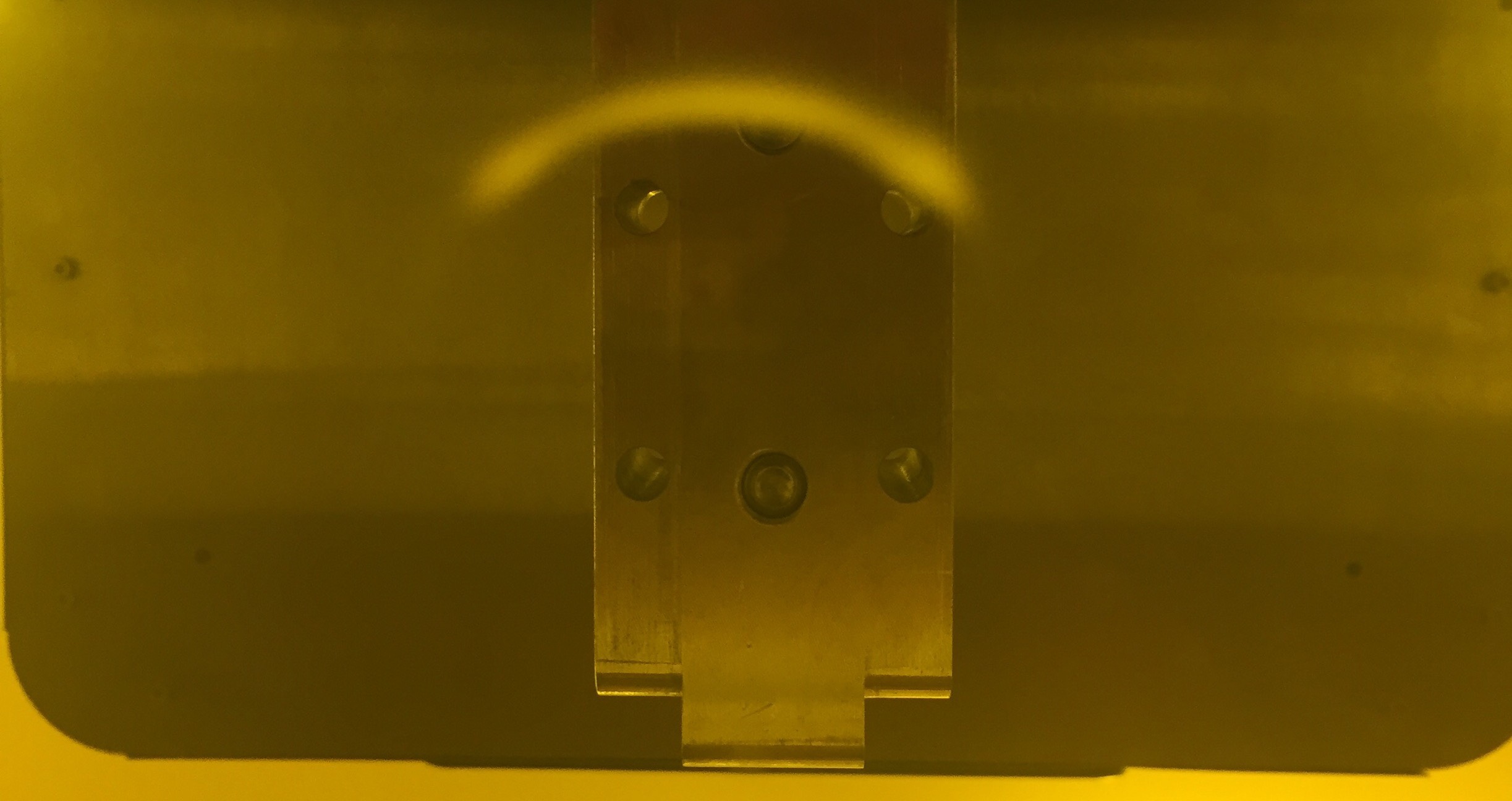

Im using pdms 3mm thick in acrylic with 3mm, in the first print pdms becomes cloud. I don't know why pdms becomes cloud...
This is about temperature? About the exposure time? About the distance between pdms and bed? Someone have this problem too? Someone can help me?

I'm running on the very same problem what i see it seem the exposure time, which resin are you using ?

Hi Nitros, im using Kevvox - ABS LC100 orange .

Apparently there are resins not PDMS friendly

PDMS and resin can have some reaction make PDMS cloudy when resin get cured. you may need to change a new PDMS after several prints. apparently your resin has badly reaction with PDMS, I suggest you use some other brand resin.
If you don't really care print quality, makerjuice is the best option, it's very cheap, easy to peel
formlabs resin is a better one, but also more expensive than B9
the envisiontec PIC 100 is the best resin I have ever used, but the price is also way too expensive.

try FEP. My VAT still works after 500h++ printing.
Re: PDMS Problem
fun-to-do resin has new resin type that provides longer lifetime of PDMS please have a look
