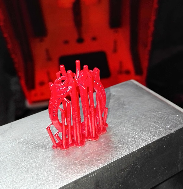

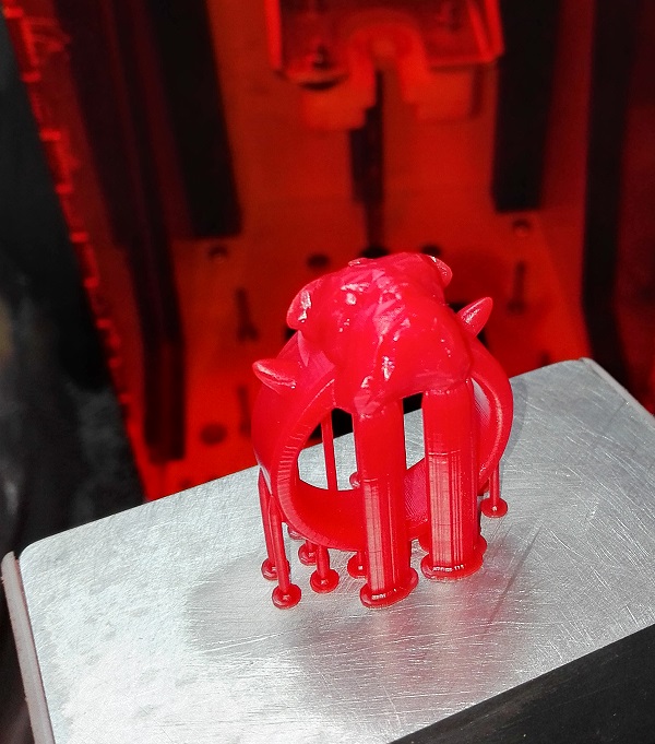

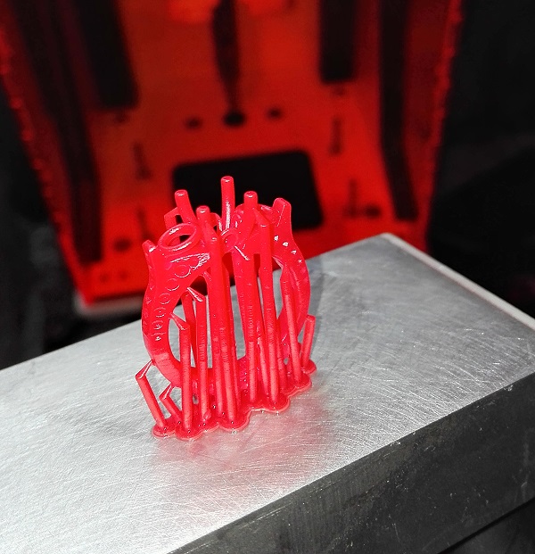

I want to tell you my experience with the LIttleRP and FLexVat . After several attempts, I have conceded good results with the following settings :
Resolution X=83,83 ; y=46,62; z=100 ( finetuning is neccessary with CW)
and for Makerjuice SUB SF 37 Micron Layer with 3850ms / 8000ms
using a ACER P1500 Projector
Greetings Kai ( a Goldsmith from Germany)
