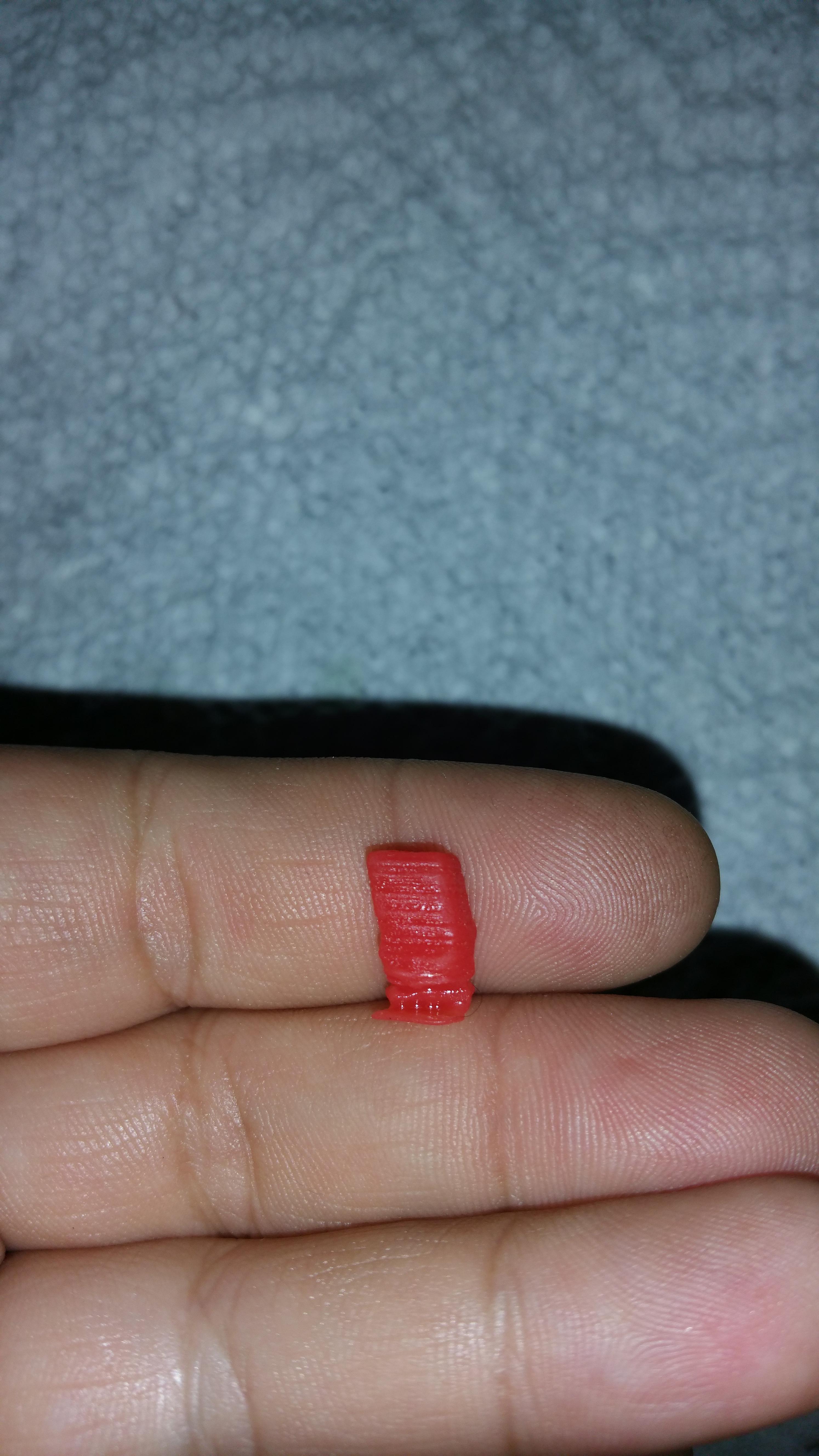

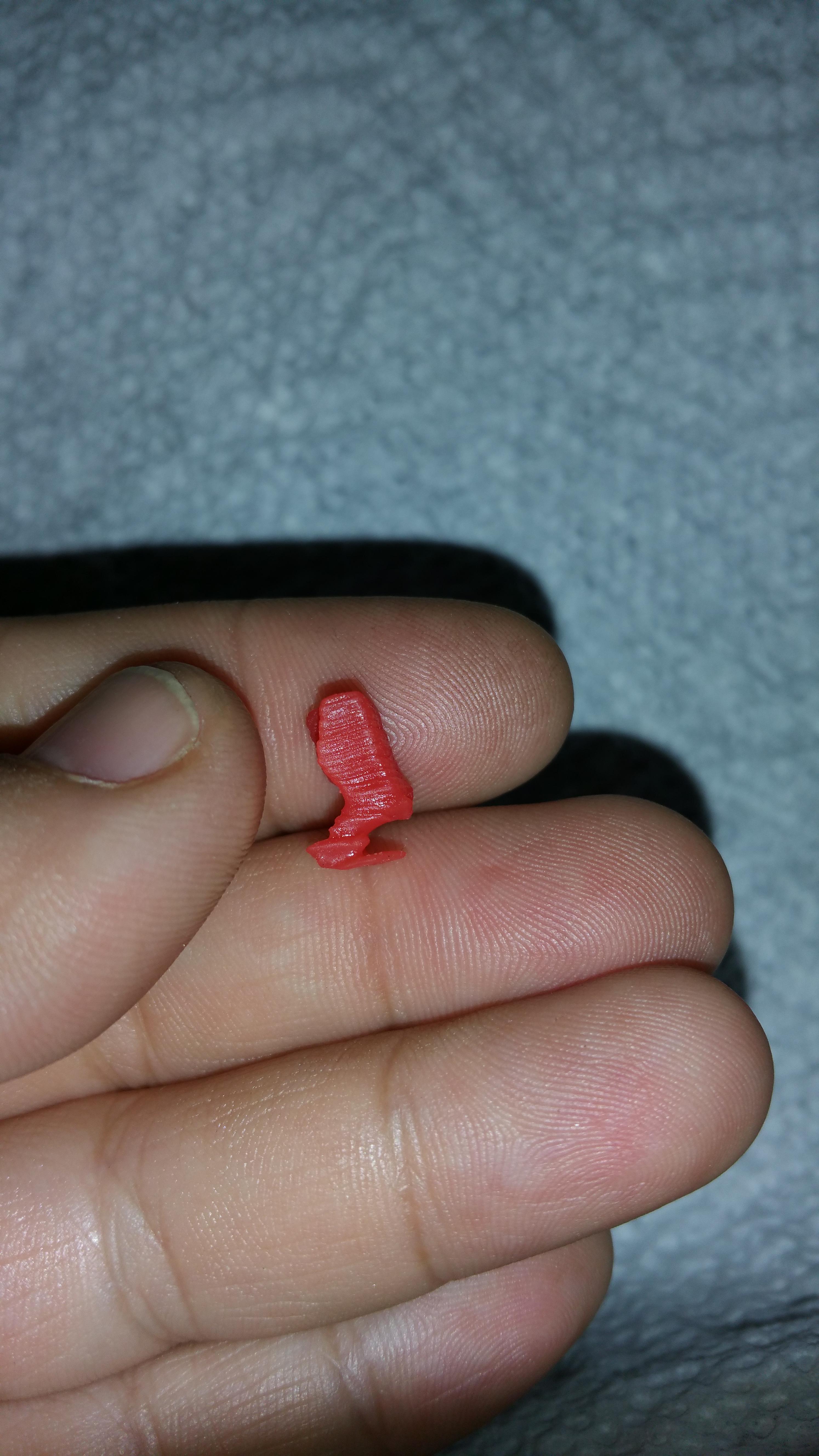

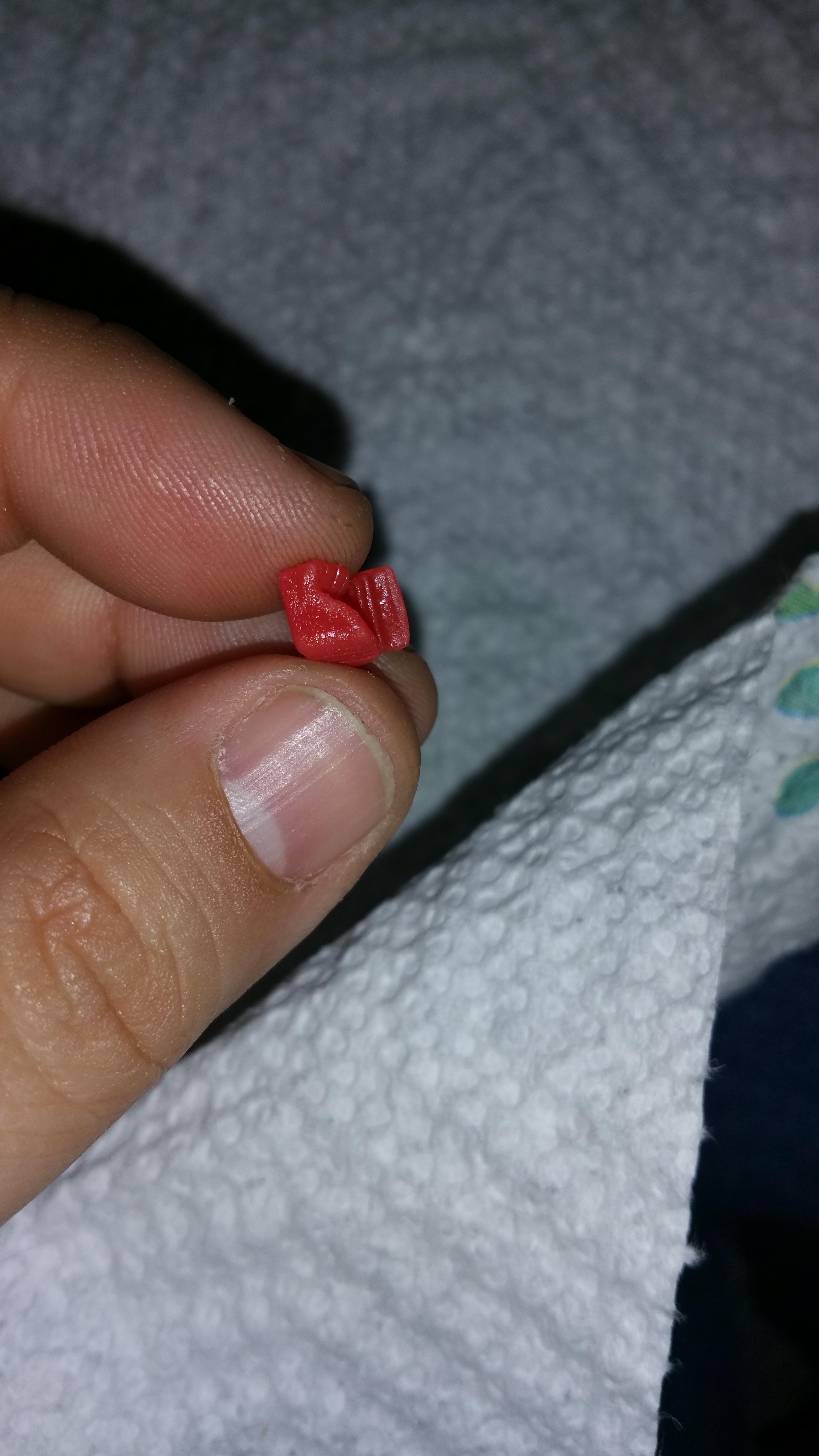

I just built a dlp top down, and all of my calibration cubes are turning out like the attached photo. I'm using makerjuice g+, a Mitsubishi xd221u projector. 8 sec per layer, 16 sec for bottom layers. I'm using grbl for my moton control.
Help troubleshooting my prints

How much settling time do you have between layers? Have you tried increasing it? Do you have any video of it printing?
