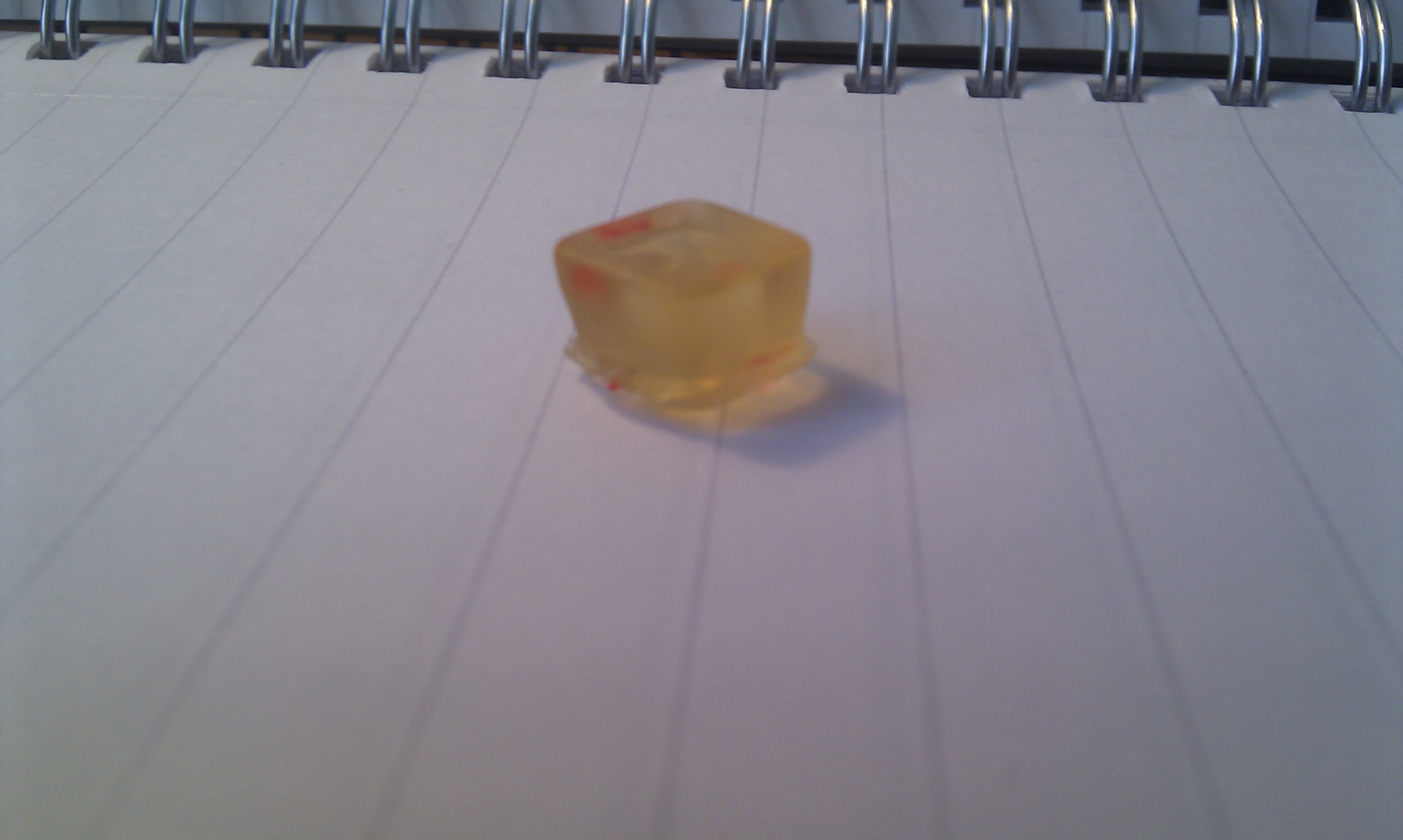

Currently trying to develop a low-level light bottom-up printer.

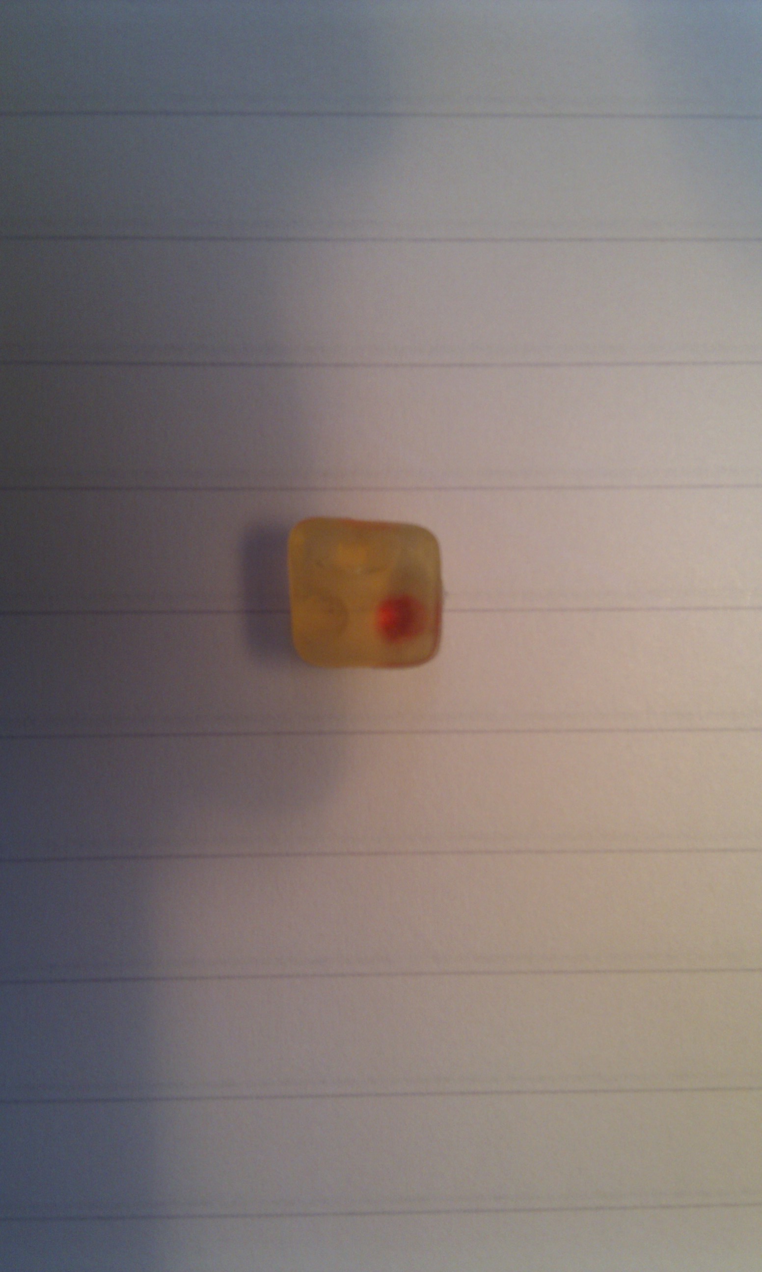

The images from the rudimentary prototype are distorted in very repeatable ways: -
- Initially layers are small and increase in area to a constant X-Y geometry.
- Cube templates taper to a point (not consistent directionality) in the X-Y plane, which also confers with an overhang in the Z-plane at this point.
Overhang in Z Axis

I should perhaps explain it is a UV LCD arrangement with Sylgard 184 screen cover at 1mm thk.
Initial thoughts are a combination of light behaviour through the various screen layers, progressive residual temperature increase generated by screen electrical components and bias toward light source (edge-lit currently).

I have butchered the LCD display to remove UV damaged part. I have used UV strip lighting along top edge close to screen components.
I managed to figure it out with a lot of surfing the various 3D boards.
It is a combination of favourable growth in the direction of the light (top of LCD screen) combined with stress-induced alteration of the 'green' resin due to the peel mechanism and slight misalignment of the print platform in the y-axis, causing peel to start in one corner, rather than at one edge, resulting in 'bulging' at the lowest point due to compression.
