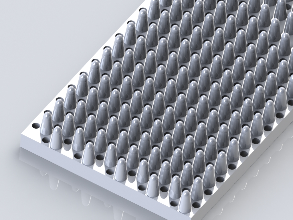

If use use structured glass or other materials you will not have this problem. In fact an added bonus would be very little to no reflection of light. See mmy post here about such materials:
viewtopic.php?f=17&t=2788&start=170#p9406
People have tested the neverwet spray with bad results but this does not equate to all forms of nanostructred materials being onworkable. For one neverwet is a chemical soup of binder and nano particles, this soup may interact with the resin leading to all kinds of unwanted effects. Nanostructed glass does not chemically react with the resin. In fact the ideal nano structure would be a combination of cones and holes that go all the way through. This in order to allow oxygen to pass through, something like the attached image. Perhaps the nano holes would in itself be sufficient in creating a "dead zone" allowing the resin to not cure on the glass and being small enough so the resin also does not leak through.

Very interesting, Ive got some very flexible Willow glass and Im going to nanocoat it with a nanocoating i got from a german company. Not sure how well it will work but i'll find out soon. Do you know where one can get this nanostructured glass? Who makes this glass?

I wouldn't bet on the fact a nano coating would be very resistant to a a resin that's being cured and releasing considerable heat. The advantage of the nanostructured material is that the nano texture is part of the material itself. As I mentioned in the other post the only companies I can find that perhaps could make/give samples are these two:
http://www.rolith.com/applications/self-cleaning
http://www.telaztec.com/index.html
