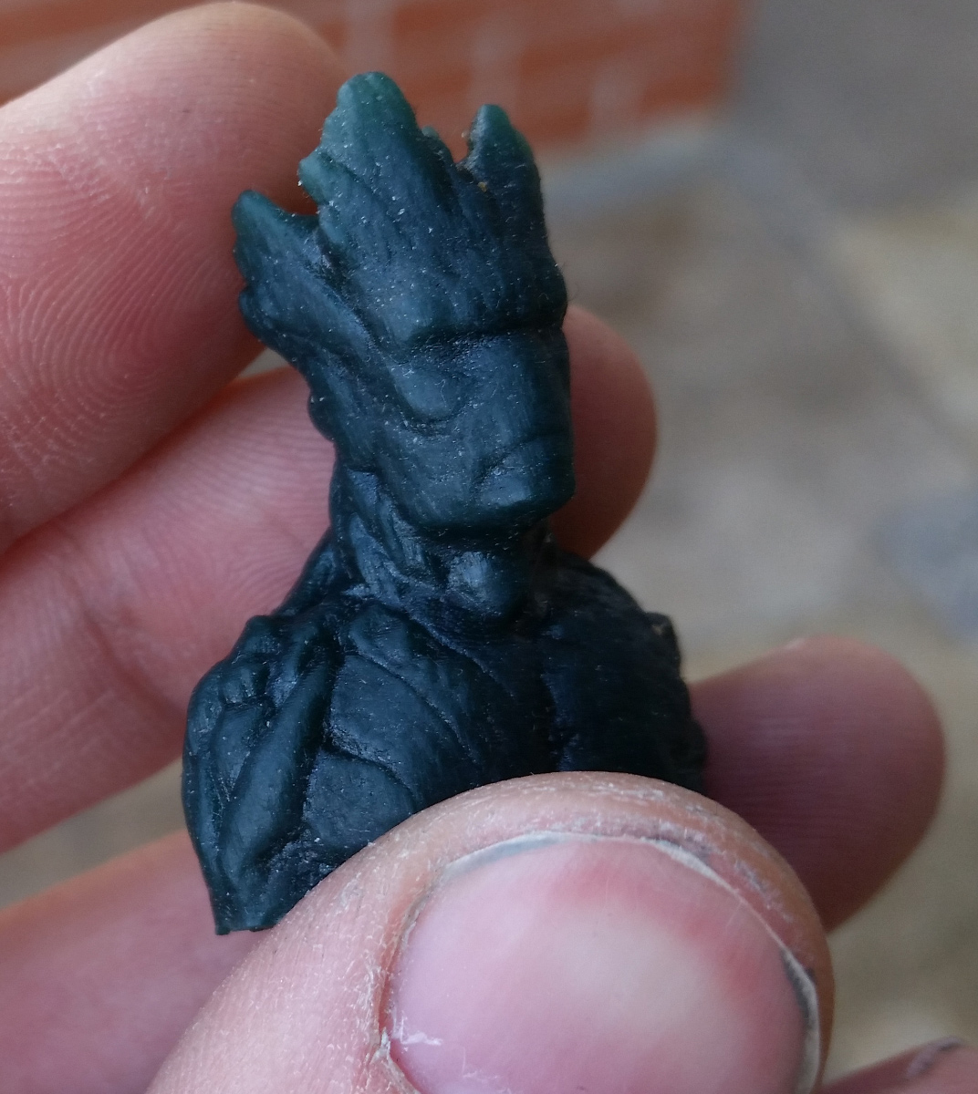

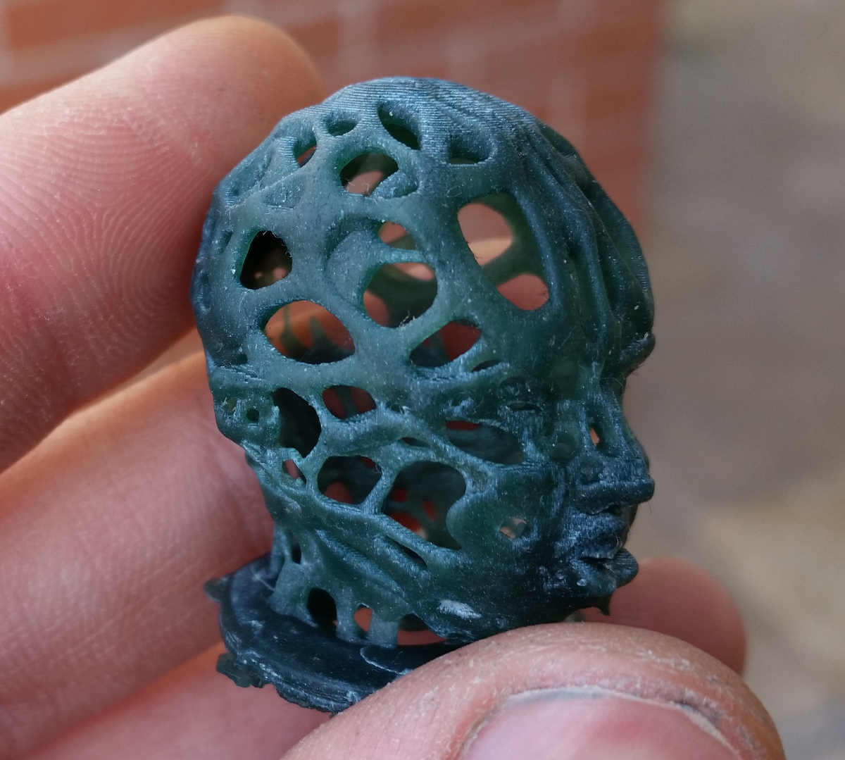

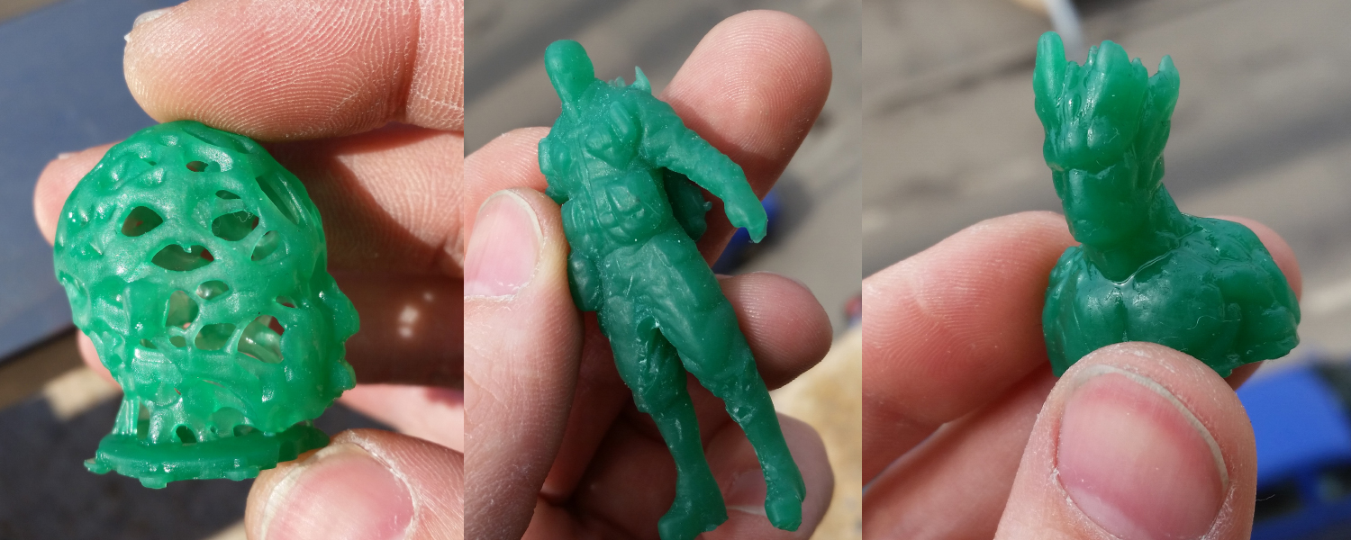

Hello. I just finished my new top-down dlp printer and in general it works ok with some problem.
The main problem is that alll details are extruded vericaly so if I have a small horizontal hole in the model it will get filled by the layers on top. Or the nose of a figurine gets all over the lower part of the face.I carefully chosen exposure time (3-4 seconds for the acer located around 18cm from the print area) and any smaller than this and the layers will not stick.
Am using a MakerJuice SUB green resin and have a feeling that because it is quite translucent the light from any layer cures little by llittle the resin below. Layer size is 0.1 mm.

Fixed. Added some nail paint poigment and quality went up like crazy.
