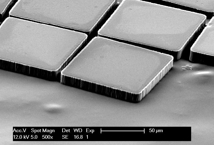

I was a bit over eager with the resolution specs--I'd be fine starting out with the ability to make 100 um x 100 um x 15-50 um thick blocks, as shown in the attached picture. I made those using traditional photolithography with a physical photomask. It's nice when it works, but it's expensive, tedious, and limited for some of the work I eventually want to do. In the short-term, 2.5 D patterning is actually fine--I just need extruded structures rather than true 3D printing. I'm planning on using very tightly controlled thickness resin layers of about 15 um thick, and then I just need to start by making some blocks. Do you guys think that it makes more sense to use a pico for this sort of application than a big gun projector? PacManFan, I'm glad to hear that your pico system is working! Dangre, thanks for the link. It's nice that people share their lamp characterizations!
I'm still exploring different material options, some of which come directly from traditional photolithography, like SU-8 (365 nm cure), and others being things like PEG-based hydrogels with various 'enone photoinitiators. I guess it helps to have easy access to academic chemical suppliers .  Liquid-Garden--riboflavin is a neat idea, but I haven't looked into it yet. Maybe I should...

100 x 100 microns isn't too hard with this technology so give it a try. Even just a simple lens mod and/or close up filter will get you below 25 microns on the xy and the PEG-based acrylics are nice to work with. Good cytocompatibility and they crosslink quickly. I haven't tried it yet but research suggests riboflavin is the way to go for eliminating the toxicity of the PI.

I can't view your image. I'm not sure if that's a problem with my browser or the upload.
