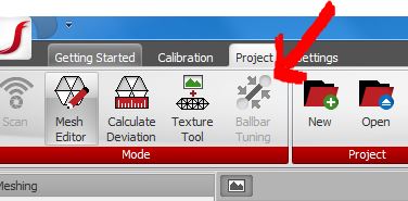

I'm currenty using 3.17 , and I didn't see the ballbar tuning in the software, where is it at ?
What version you're using ?
Thanks
Alex
Thanks again for your reply .

- Attachments
- Capture5.JPG (25.09 KiB) Viewed 34937 times

On the ball tune, is that mean we place a ball that have a diameter of 5cm and if the scanner couldn't read 5cm then we tell the system that the ball is 5cm ? so it will re-calbrate it self with the number we input in ?
Am I correct ?

on the ballbar tuning , do i input the lenght of the bar or the diameter of the ball ?
thx man
alex
thx man
