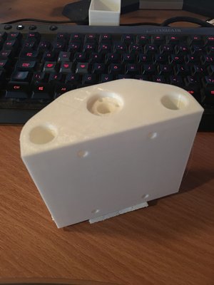

I also had a go at printing the large block that contains the bearings and lead screw nut for the z-axis - its worked quite well. Which is ironic as it seems to be the only good print I have had out of the CTC printer.
