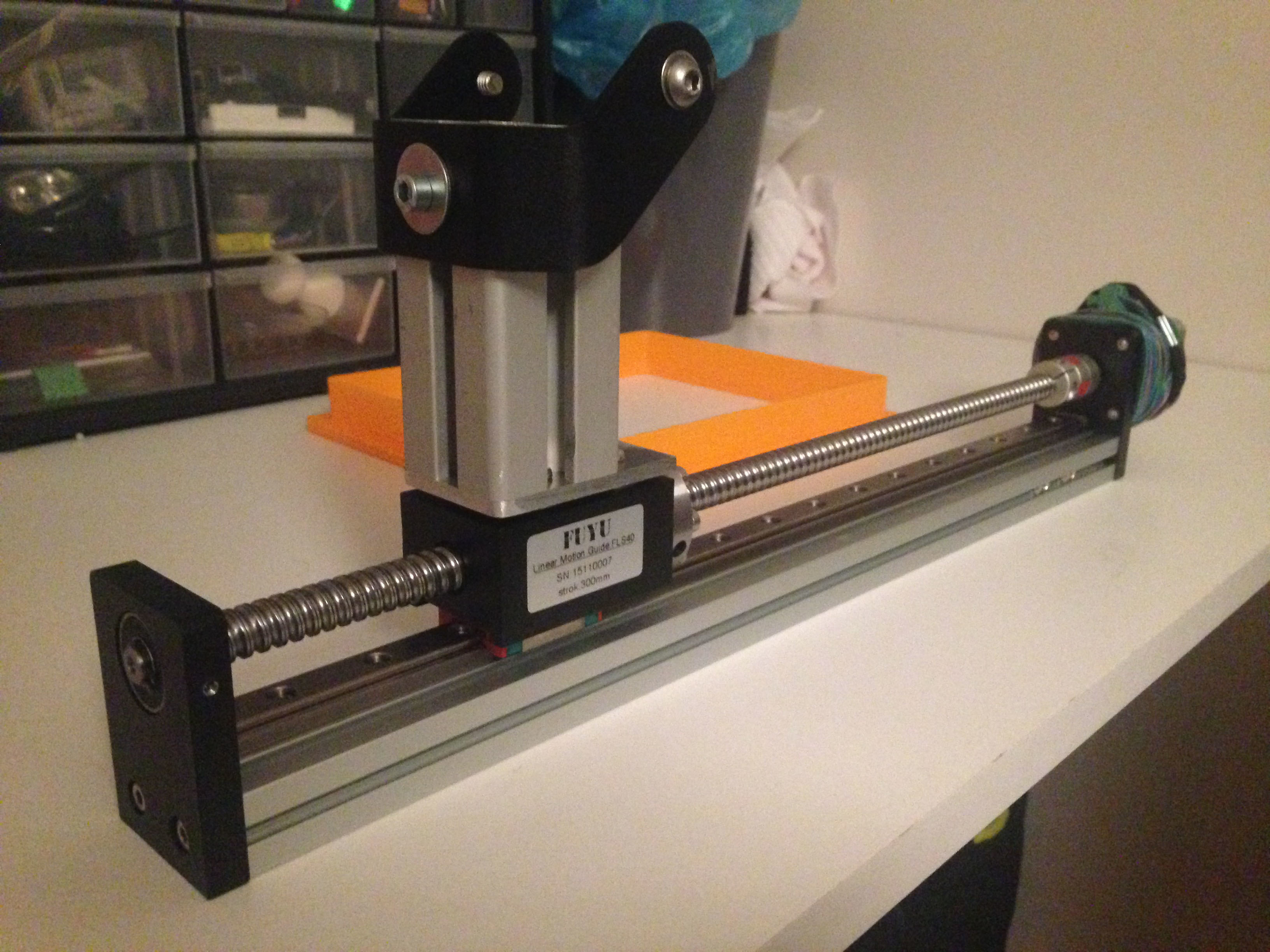

2016-04-21T07:19:16-04:00 2016-04-21T07:19:16-04:00 http://www.buildyourownsla.com/forum/viewtopic.php?t=4987&p=14606#p14606 <![CDATA[Re: Daylight (iPad) Printer]]>
- Build Platform
- VAT
- Top Frame Plate
- Enclosure
ETA 2 Weeks + Buildtime

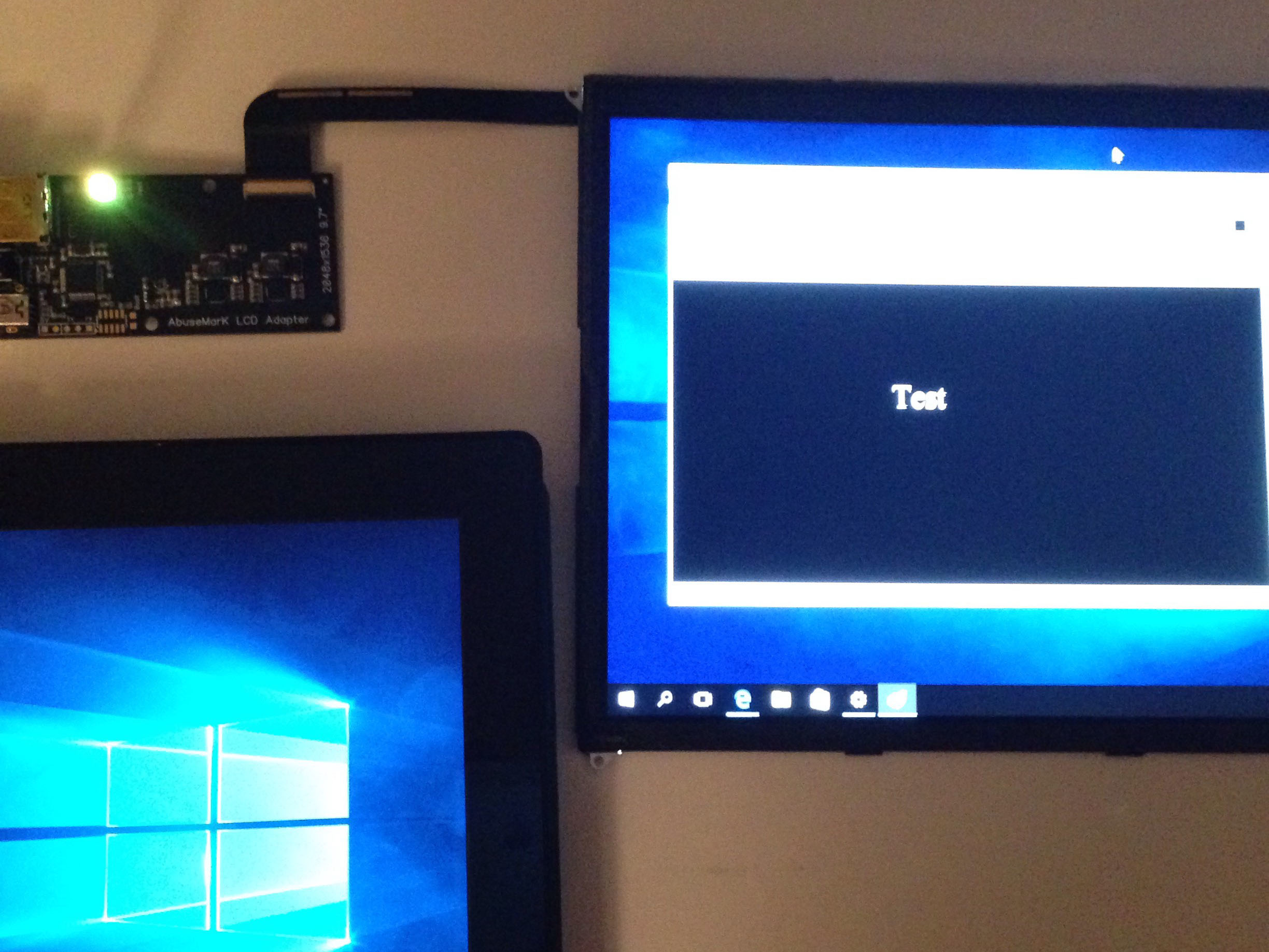

2016-04-14T15:10:19-04:00 2016-04-14T15:10:19-04:00 http://www.buildyourownsla.com/forum/viewtopic.php?t=4987&p=14575#p14575 <![CDATA[Re: Daylight (iPad) Printer]]> Did FW and Electronics this week.
- Added two code-commands to Marlin FW (1 to control text in a smal OLED display and 1 to Control iPad Display back lightning).
- Not to easy the last part, since hardware Serial not possible. Software Serial is however.
- Added a 12V->5V transformer for powering the Abusemark Display driver.
- Soldered all wires for the serial communication interface, and figured things out in general.
Next is Routing out the plate for the VAT, and the VAT itself (design change here).
To be continued.

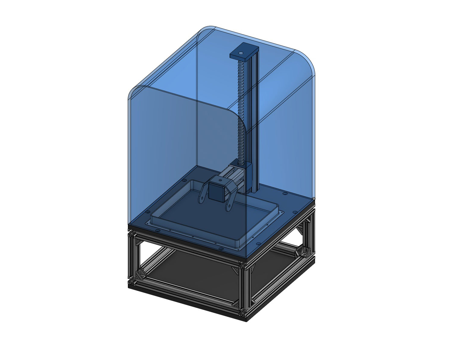

2016-04-14T16:37:41-04:00 2016-03-24T17:36:58-04:00 http://www.buildyourownsla.com/forum/viewtopic.php?t=4987&p=14449#p14449 <![CDATA[Daylight (iPad) Printer]]>
Some links :
My first SLA project :
This project (buildlog) :
Previous thread for testing :
Here is the concept and what I got ready so far.
