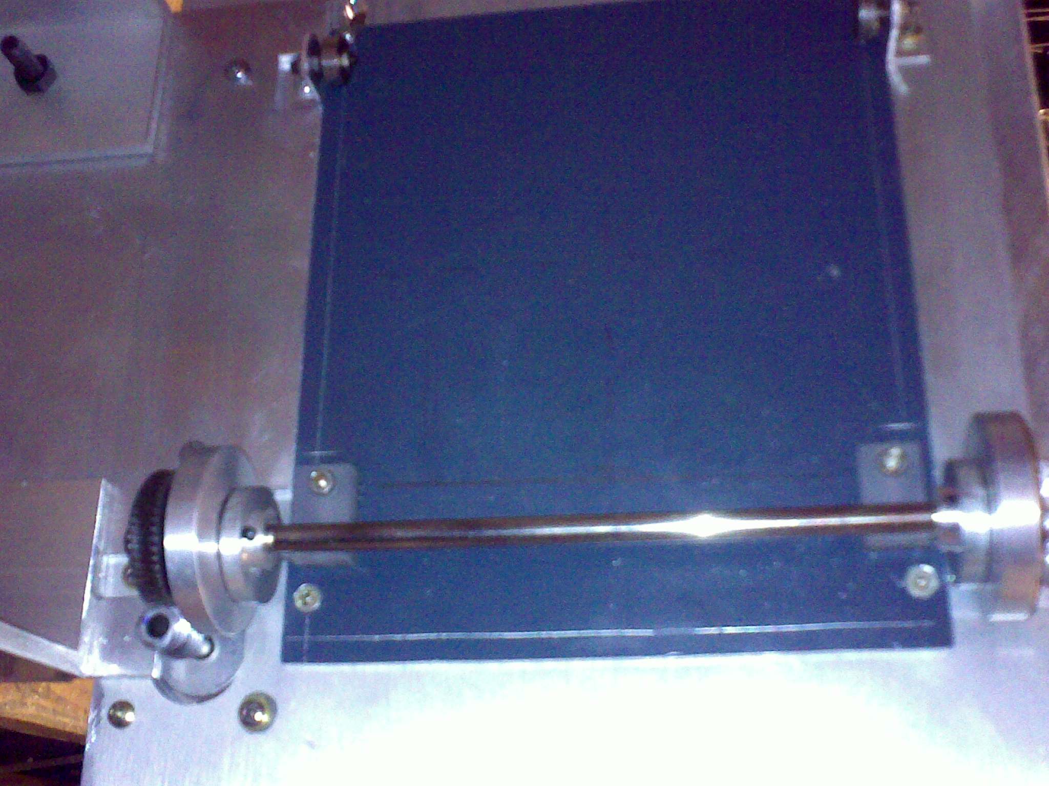

2014-02-09T13:49:31-04:00 2014-02-09T13:49:31-04:00 http://www.buildyourownsla.com/forum/viewtopic.php?t=136&p=595#p595 <![CDATA[Re: DLP 3dprinter build]]>
Its driven by worm and wheel, salvaged of course.

2014-02-09T13:30:47-04:00 2014-02-09T13:30:47-04:00 http://www.buildyourownsla.com/forum/viewtopic.php?t=136&p=594#p594 <![CDATA[Re: DLP 3dprinter build]]>
What is your VAT made of Plexi? And your tilt mechanism I assume runs of the smaller stepper on the side, any info on the actual linkage etc?

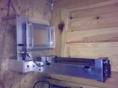

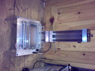

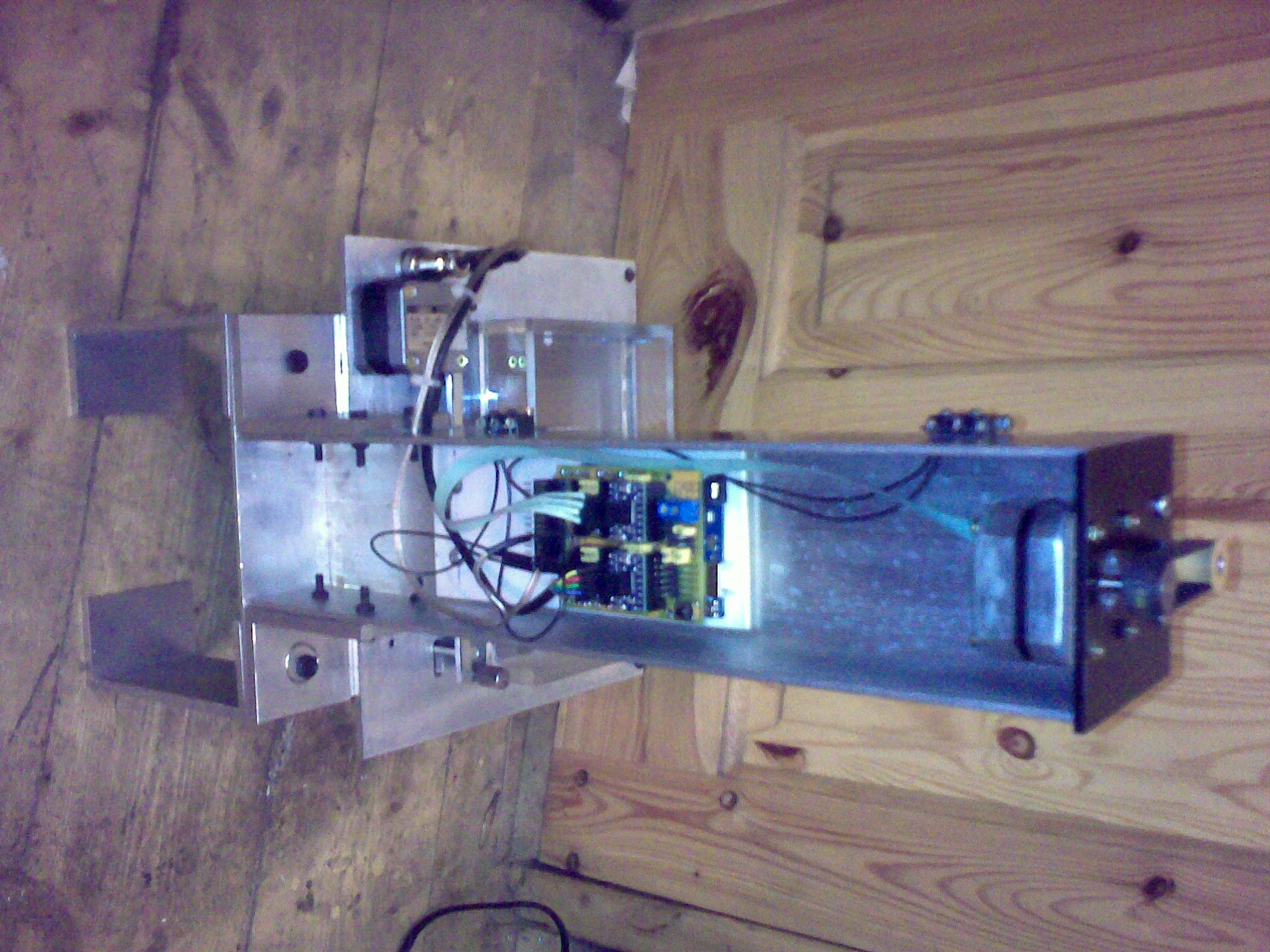

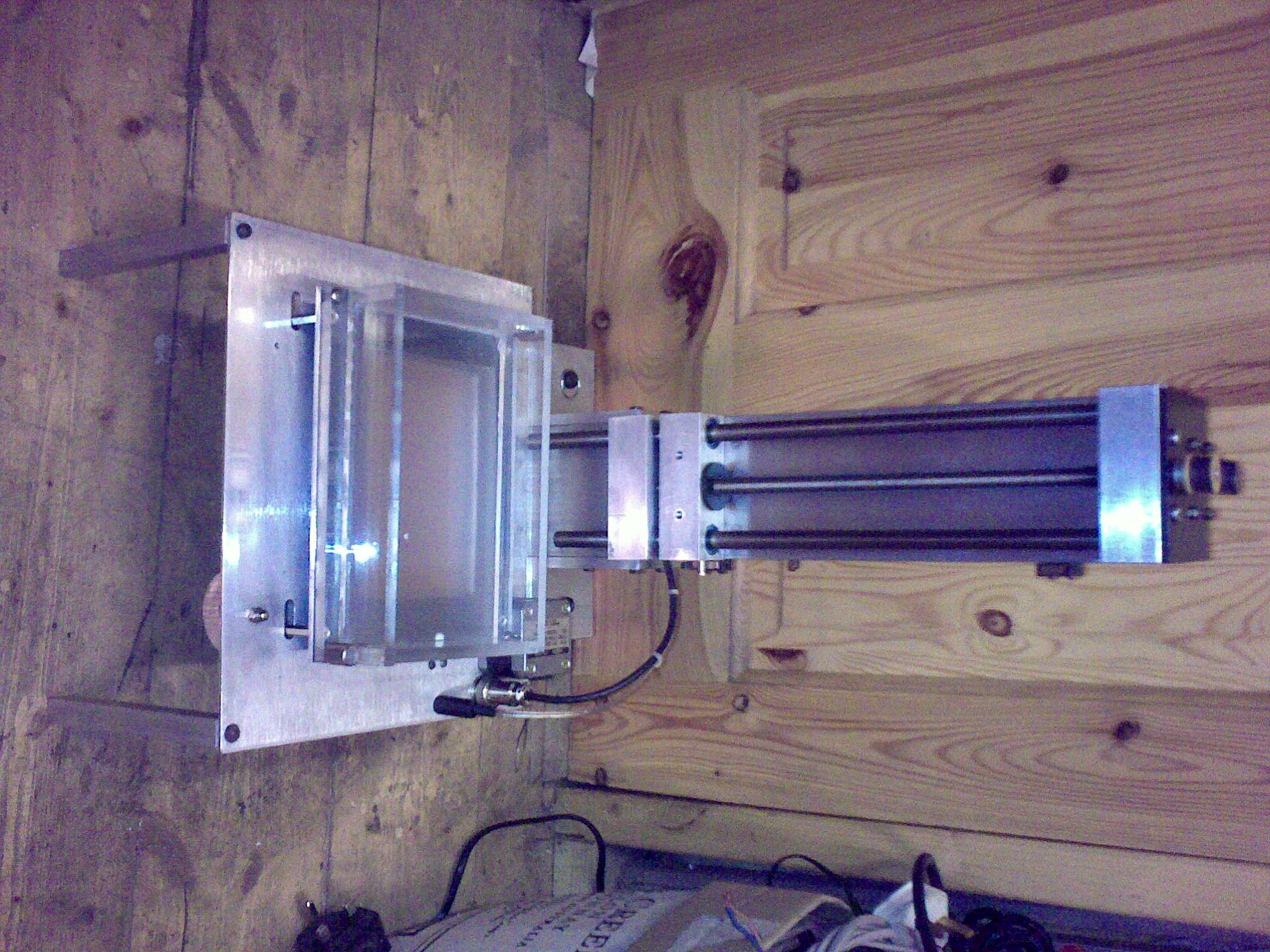

2014-02-08T18:07:17-04:00 2014-02-08T18:07:17-04:00 http://www.buildyourownsla.com/forum/viewtopic.php?t=136&p=591#p591 <![CDATA[Re: DLP 3dprinter build]]>
sorry, forgot to rotate them.
The z axis rods are genuine stubbs silver steel I have had for some time, not hardened, but should
last for a while, ball bushes, and 3/8 bsf threaded rod leadscrew, (.050 pitch) also had this for some time, its a lot better quality than the studding these days, the leadscrew nut is made from oilon, "nylon cast with a lubricant", no backlash and very smooth.
The z axis is a piece of ally channel, 3"x2" and made to fit the stubbs rods without cutting them,
down, the rod holders and slide were bored on a milling machine.
the motor is salvaged from who knows, it has a resistance of 4ohms on the windings, so pretty powerfull for its size.
