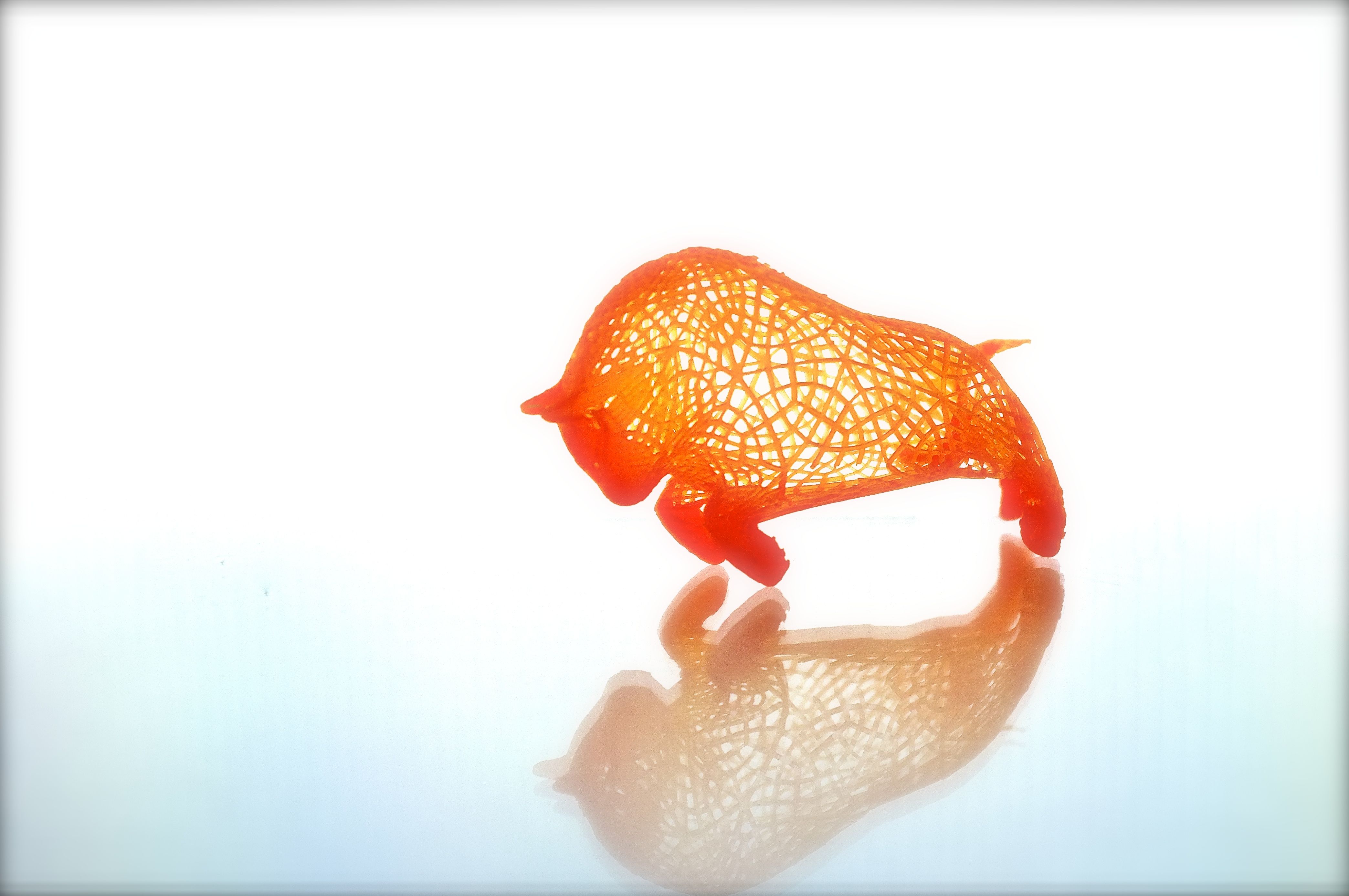

checkout the bull we printed ..
also Flex VAT :)
Cheers,
