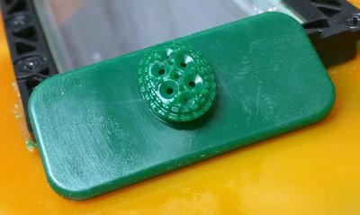

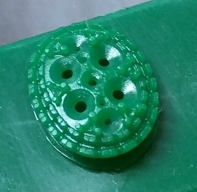

I successfully printed my first model on Ember using FEP instead of PDMS.
I challenged myself to do a proof of concept. As any other preliminary test, the first results only show potential, not quality nor speed or ease of use.

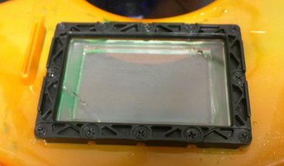

- Unscrewed and detached the glass/PDMS assembly.
- Used scalpel to carve a window on PDMS.
- Used a chisel to remove the inside part of PDMS from glass, leaving a border in place.
- Used a diamond encrusted drill bit to open a hole in the glass, for air pressure to equalise. Managed to break the glass not once but twice !
- I sandwiched a sheet of FEP film and tightened the bottom screws.
- I could not get the tension right, Adhesion was not possible, since Ember's build platform is large I printed a 2mm pedestal in an effort to achieve tension. To do that I used an unmodified tray, and let the printed plate on the platform.
- I increased and Z axis overlift, set 0 degrees rotation and disabled jamming detection.
- Clicked print*
Result shows good promise. There was some sweating of resin in the bottom, I advise caution to anybody who tries to replicate this test.
