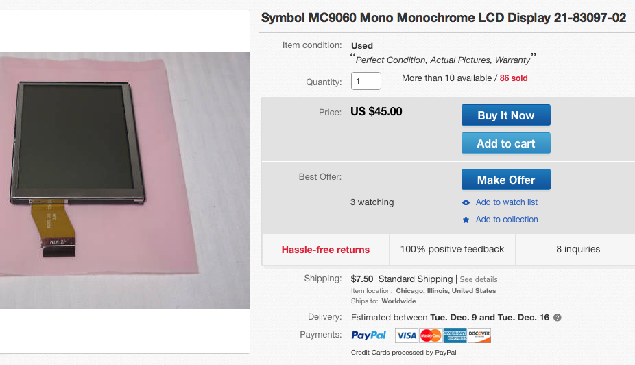

2014-12-06T13:14:48-04:00 2014-12-06T13:14:48-04:00 http://www.buildyourownsla.com/forum/viewtopic.php?t=2152&p=6518#p6518 <![CDATA[Re: Simple Light control]]>
Statistics: Posted by SIDRANA — Sat Dec 06, 2014 1:14 pm
