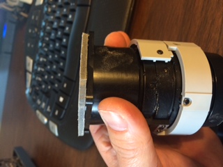

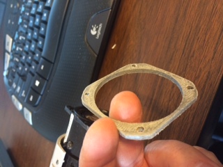

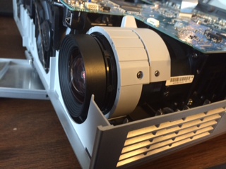

I had to modify the lens of my Toshiba projector. I printed out a 3mm spacer to put in the projector. I used the customizable cylinder on thingiverse (I can't draw), printed it out, sanded it into a square, and drilled the holes. It decreased the throw distance to about 10 inches.
