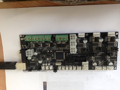

I was looking at trying my hand at DLP printer aftering having worked with some FDM ones. I have the board left over its attached in the photo. What type of firmware should I use and how is it going to deal with all the extra inputs that it has like temp and so on. I just really need the zmotor off it and an endstop maybe a tilt motor. Also how can I deal with diffrent slicing depths and steping. I plan to do my z-axis on a ball screw. Thoughts? Input?
