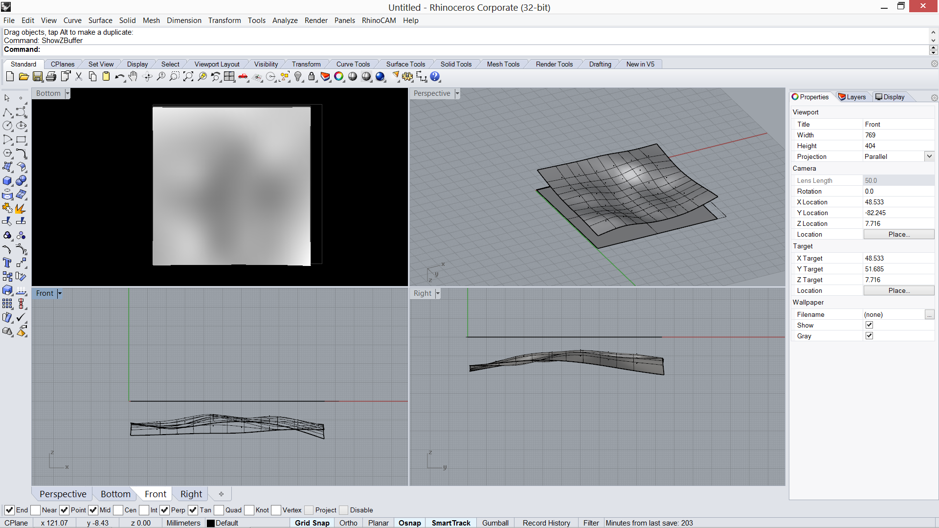

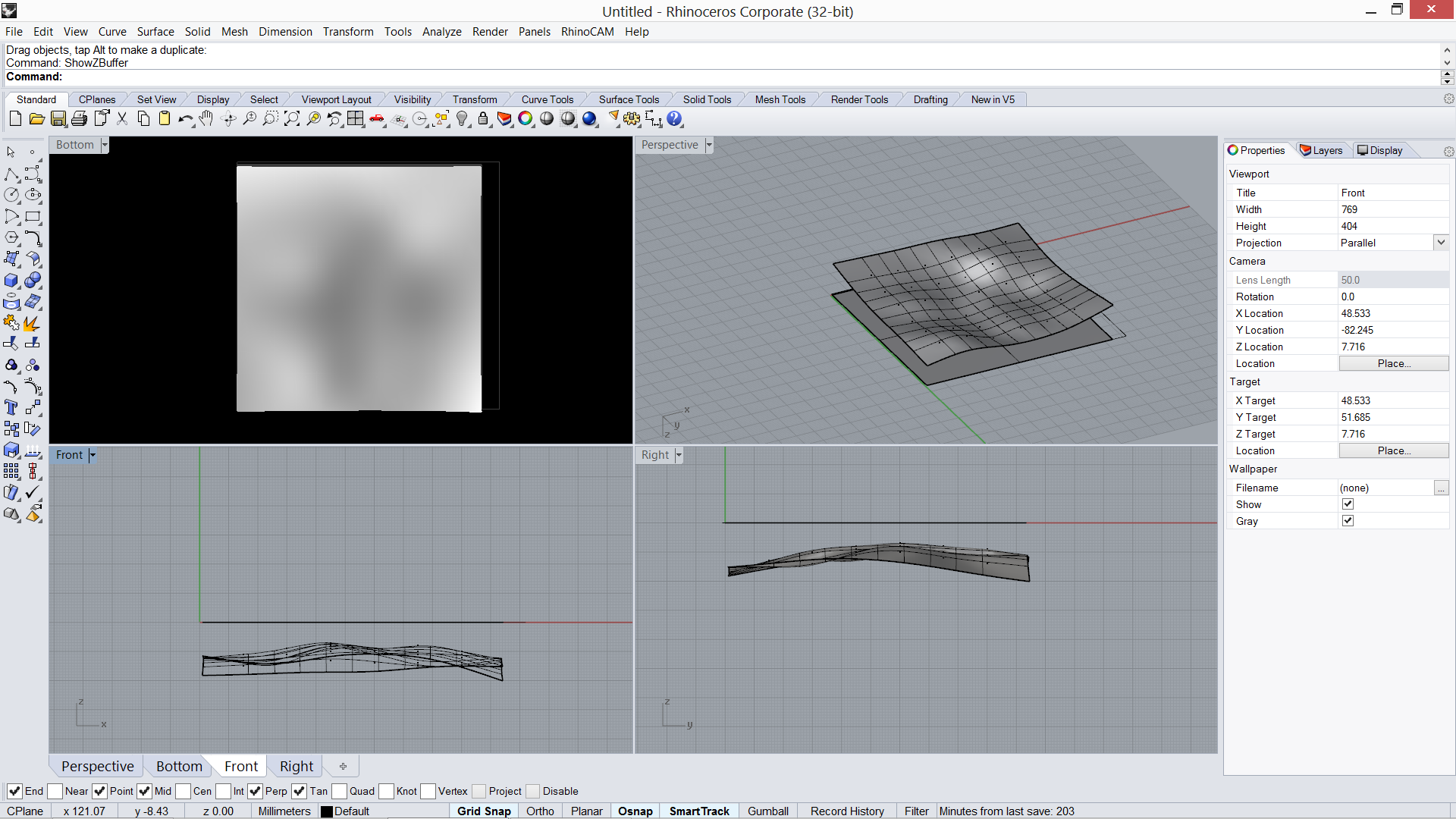

2015-08-07T17:40:47-04:00 2015-08-07T17:40:47-04:00 http://www.buildyourownsla.com/forum/viewtopic.php?t=2096&p=11619#p11619 <![CDATA[Re: Mask]]>
Statistics: Posted by nc42 — Fri Aug 07, 2015 5:40 pm
2015-08-07T17:02:28-04:00 2015-08-07T17:02:28-04:00 http://www.buildyourownsla.com/forum/viewtopic.php?t=2096&p=11617#p11617 <![CDATA[Re: Mask]]>
My current plan is make a png file of white dots on a grid and take sensor readings from that. I'll then input those as a point cloud in Rhino and use the "Patch" command to make a surface from them. I'll then take the surface and use the "ShowZBuffer" command to shade the surface by height (UV energy read by sensor" Then I will out put this as a .png Not the cleanest work flow, I'm sure there is a way to do this with software but I don't really have the time to put in to that right now...
