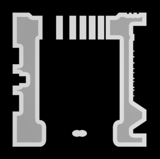

2017-09-02T11:35:57-04:00 2017-09-02T11:35:57-04:00 http://www.buildyourownsla.com/forum/viewtopic.php?t=5934&p=21298#p21298 <![CDATA[Re: MonoWare Lite - Slicing and control software for resin printers]]>
Now new version (MonoWare 0.1.014) is available on our website. https://www.monoprinter.com.
Brief summary of update is as below
- Separate menu window for printer settings
- Motor, slice, printing settings are adjusted inside the printer settings window
- Barrel distortion correction, uneven light intensity compensation added
- Anti-aliasing, barrel distortion correction, light intensity compensation, and dimming is processed on the fly, so you don't need to these processes before printing.
* Slicing on the fly will be added in the next release.
- Supports Marlin (Muve patched version), but not complete yet.
** G-code supports are not complete, so please test and dry run firstly.
The printer setting menu is located under "Printer" tab.
Below is a slice image after some image correction and processing.
Please let me know any issue at info@monoprinter.com, or reply to this message.
Yun
Statistics: Posted by cooly — Sat Sep 02, 2017 11:35 am
