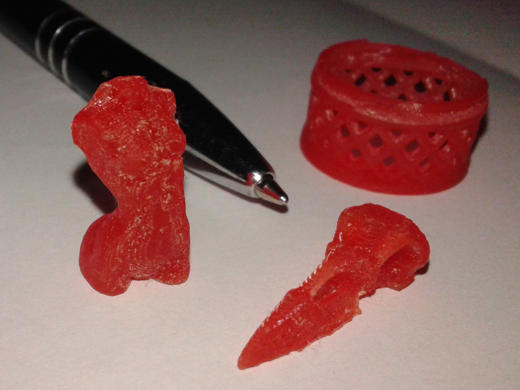

2015-03-09T03:12:29-04:00 2015-03-09T03:12:29-04:00 http://www.buildyourownsla.com/forum/viewtopic.php?t=2753&p=8716#p8716 <![CDATA[Re: Print problem]]> #define Z_MAX_POS 200
#define Z_MIN_POS 0
and the prints look like this if are tall then 10 mm
first print was meant to be a cylinder, but...

2015-03-08T08:42:48-04:00 2015-03-08T08:42:48-04:00 http://www.buildyourownsla.com/forum/viewtopic.php?t=2753&p=8696#p8696 <![CDATA[Re: Print problem]]>
Sounds to me like your firmware is set to max z-height of 10mm, so it won't let you get beyond that. In Marlin that be the Z_MAX_POS setting in Configuration.h . Sounds like that is set to 10 for you.
