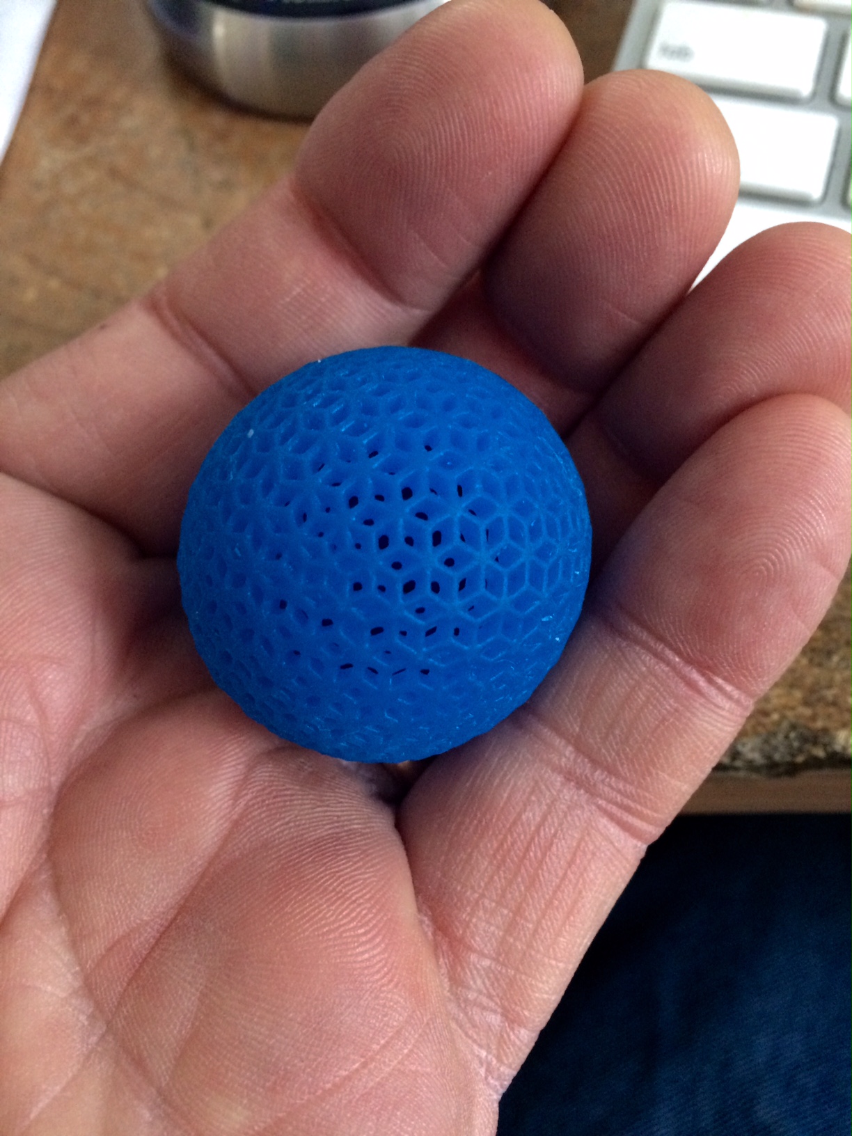

I turned down brightness from 50% to 30% and increased the part diameter to ~30mm. I'm guessing based on what little I know that this is still over exposed.
I've turned down the brightness to 25% and trying another run. But, I am interested in why my projector would need to be lowered this much (or more). I thought more UV the better? I removed the UV filter and color wheel on this projector, was that a mistake? I haven't tried any of the other colors (I have all of the G+ colors).

2015-02-16T21:01:43-04:00 2015-02-16T21:01:43-04:00 http://www.buildyourownsla.com/forum/viewtopic.php?t=2688&p=8375#p8375 <![CDATA[Re: Getting closer to first print, Z axis issue...]]> Here's the latest after reducing exposures to 2500/500ms and fixing the X/Y resolution:
It is starting to show some definition and the open structure. I don't have IPA to wash so I washed with denatured ethanol. I also didn't UV or sunlight treat this. As it "cured" over the last 10 minutes or so, the definition seems to be getting better and more pots seem to be opening up. I presume this is normal - that the prints "develop" a bit after coming out of the machine? Would you say it is still a little overexposed? I'm also not sure how to go about tuning Z lift and speeds, etc because I don't yet know what to expect when I make a change. But I do seem to be moving in the right direction!

2015-02-16T18:24:04-04:00 2015-02-16T18:24:04-04:00 http://www.buildyourownsla.com/forum/viewtopic.php?t=2688&p=8369#p8369 <![CDATA[Re: Getting closer to first print, Z axis issue...]]> first, the model looks very over-exposed - try lowering your exposure time by 1/2.
second, if the z-axis is indeed jogging 10mm when you click the 10mm button, then the X/Y scale must be set incorrectly. Measure the projected X/Y image on the surface of the vat, and enter those numbers into your Machine Configuration screen. Also, be sure to check the projector resolution is set correctly.
It looks like you're very close...

2015-02-16T17:30:16-04:00 2015-02-16T17:30:16-04:00 http://www.buildyourownsla.com/forum/viewtopic.php?t=2688&p=8361#p8361 <![CDATA[Getting closer to first print, Z axis issue...]]>
I scale it so it is about 23mm in diameter. After centering the image properly I ran another print and now it is starting to look less like an amorphous blob! But I still have issues. Here are some photos - I terminated the print at about 75% complete:
As you can see, Z is elongated. However, when I jog say 10mm I actually measure 10mm of movement, and it matches the steps per calculation. Perhaps I am missing the meaning of Z in the printer configuration tab. I have it set to 150. I presumed that to mean I have 150mm of travel but perhaps it is a scaling factor.
Is there a way to tell from these (horrible) photos if the exposure is even in the ballpark? With Z axis stretching I would have expected the holes to be even more prevalent but instead the object is a solid shell. Is this an artifact of over exposure?
