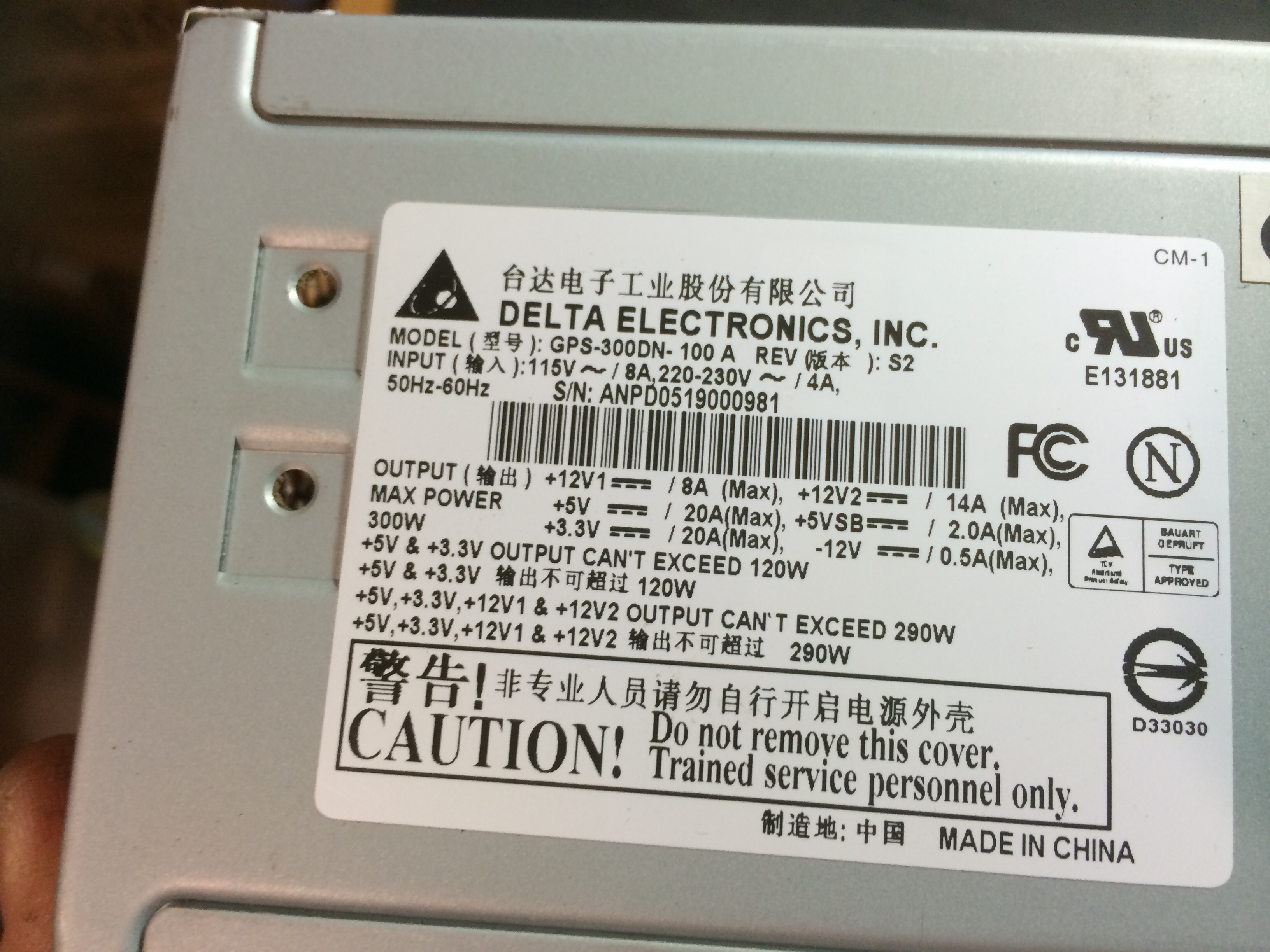

what iv changed
Replaced nema 17 with nema 23
upgraded step stick to drv8825 (also tried other brands)
hard wired the power supply and stepper connections
used 3 different power supplies
tried marlin and sprinter
every time iv changed something i tried and still the same result, works fine with the ramps 1.4 firmware but when i try marlin or sprinter with creation workshop the stepper just buzzzes, what am i doing wrong?

2014-06-21T04:44:16-04:00 2014-06-21T04:44:16-04:00 http://www.buildyourownsla.com/forum/viewtopic.php?t=1486&p=4052#p4052 <![CDATA[Re: Drivers needed to controll mega 2560]]>
i actually thought it was the power supply and so changed to another one but still the same
i will report back with results
