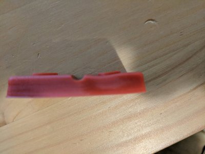

1) may not be good enough buildplate adhesion, makerjuice will sometimes require a base on a part. Is the part still stuck to the baseplate in all areas when you are done?
2) the film may not be tight on both sides of the vat. to get some more tension, you can remove the clear spacers and tighten the vat down further. If the vat film is loose, it will deform and transfer this deformation to the print.

1. The main issue. After printing for about 6 hours, I now have a band that goes across my print area, where if I print out a full print, it is shrunken in height at that area. I started a print and cancelled it after two layers- the build plate had a visible band there where resin did not cure... Did I melt something, or melt part of my projector? - Attachement showing a full print with a shrunken bit. Both sides should be identical and flat. The undercured? band makes it curved. (I did not replace my Teflon in the vat yet. Could that be related?) - Photo attached of a result. It's blurry, but it is the best photo I have that shows the issue, quite clearly. Sorry for the low quality- it's close to midnight and I am being lazy ;)
