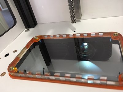

2017-06-08T18:30:07-04:00 2017-06-08T18:30:07-04:00 http://www.buildyourownsla.com/forum/viewtopic.php?t=6111&p=18117#p18117 <![CDATA[Re: Little RP2 - Setup and issues]]>
Not having all the lines on the buildplate may or may not be an issue, if you just avoid the very outer perimeter when laying out your parts it won't cause an issue. Other options are to make sure the zoom ring is all the way unzoomed, the x152h also has a second set of mounting holes that are more forward that will result in a smaller projected image.
If the x152h runs into the square base in this forward position, that is what those two long skinny plates are for they replace the square base leaving the center open. With the x152h removing (pulling off) the front silver focus ring of the projector will give you more room to work with.

2017-06-08T02:10:24-04:00 2017-06-08T02:10:24-04:00 http://www.buildyourownsla.com/forum/viewtopic.php?t=6111&p=18106#p18106 <![CDATA[Little RP2 - Setup and issues]]>
I have received my Little RP2 the extended height and build area version. Managed to set it up (probably incorrectly).
I have been using B9 Black resin, and the project is the Acer X152H
My main issue is when im trying to focus the projector (Acer X152H) i'm unable to get all of the focus lines square and to fit in the actual build area.
I also dont think i should have to have the projector like this.
And there seems to be a few to many left overs :O
Would also like to know where i can get replacement film and foam for the vat.
