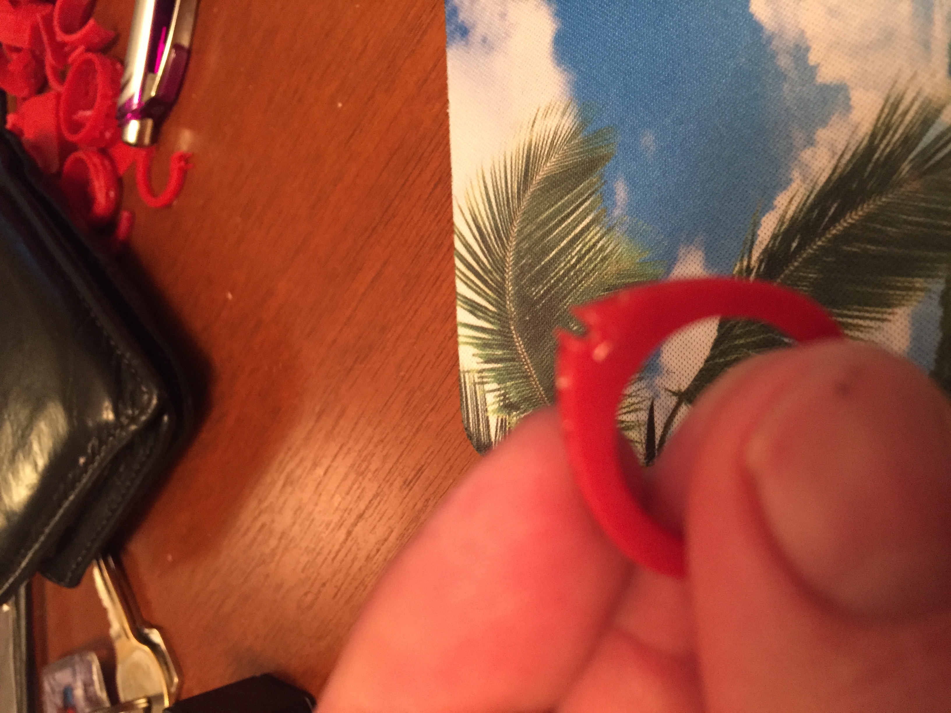

2015-03-01T01:07:16-04:00 2015-03-01T01:07:16-04:00 http://www.buildyourownsla.com/forum/viewtopic.php?t=2733&p=8609#p8609 <![CDATA[Casting With the LittleRP]]> i'm working on using the littleRP to cast and print rings, so far I been seeing a lot of hits and misses
for the resin I have been using a mixture of 1:1 of both b9 resins (cherry and red)
the burn out seen to be nice and with respects to that no problems so far, still waiting for pictures back from the gold smith
I have been using an exposure time of 20000 for the support layers and 17000 for the ring themselves, but for thinner rings I bring that down to 14000
the only problem I been having with this is the exposure wears the dishes out really fast
I have ordered the new madesolid casting resins and will post how I find that
I find the shrinkage to be pretty much spot on at 3.5%
