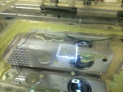

Build Your Own SLA/SLS A forum dedicated to helping you build your own SLA/SLS-based 3d printer 2014-11-05T12:37:26-04:00 http://www.buildyourownsla.com/forum/feed.php?f=16&t=2105 2014-11-05T12:37:26-04:00 2014-11-05T12:37:26-04:00 http://www.buildyourownsla.com/forum/viewtopic.php?t=2105&p=5950#p5950 <![CDATA[Re: multi-layered VAT caused too many reflections]]> to oliyeen: giving up testing resin from ebay/taobao, we are working with a friend's company now, it is based in Shenzhen called feiyang. Are you making any progress?
glacian22: thx for replying, i will test PMMA when I have time. interestingly, my projector doesn't have option to adjust brightness, the most i could do is turn on eco mode.

I'm also in China , Shenzhen , I have no clue for the UV resin too ( expensive, no data sheet ... ), would you mind sharing your suppliers ?
You could maybe add a shutter to cut the light between each layer ?

2014-10-28T00:00:52-04:00 2014-10-28T00:00:52-04:00 http://www.buildyourownsla.com/forum/viewtopic.php?t=2105&p=5847#p5847 <![CDATA[multi-layered VAT caused too many reflections]]> The VAT is built with borosilicate glass covered with unsticky .05 FEP membrane and the rest of basin is built with PMMA. DLP is H6510BD, ECO mode on to reduce the brightness, and during first loop of test , I tried curing a layer for 2-4 seconds.
Because I am based in Hongkong now, there are no easy access to resin suppliers like FTD, therefor I sourced different resin from China for test, which is very painful. and you know what, they are not cheaper.
1. The first resin I tested is yellowish transparent resin, it bleeds alot even if I set cure time to 1000ms. After I clean the basin, I found the resin around the edge are cured as you may see in the photo. I have no clue what cured these area. Did this happen to any one?
2. Take a close look at the VAT, I can see many layers of reflections of the image projected, particularly a strong projection on top layer, which I guess is FEP. is this normal? or is it because membrane or glass isn't transparent enough? will this cause bleeding to the rest of resin?
3. and in the end I did a test, I expose resin under dlp in blank, and there are still light leaks on in blank which as a result slightly cured the resin in 10-20 minutes. Is it because the resin is too sensitive? and will adding pigment help?
I wish i could understand more of these before I start another loop of tests, there are so many concepts missing in my knowledge, and I appreciate any advice or suggestion. Thank you guys in advance,
