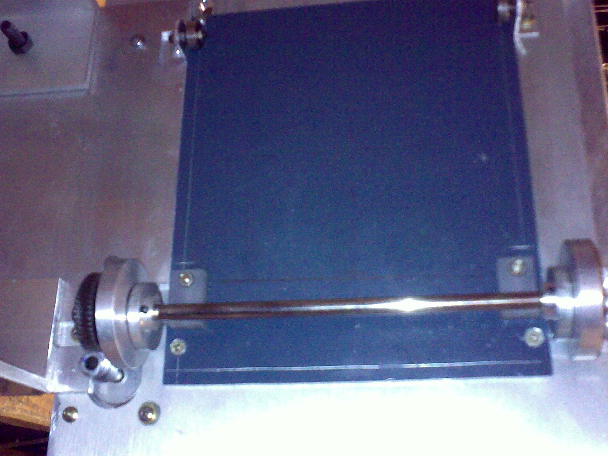

2013-12-04T15:05:10-04:00 2013-12-04T15:05:10-04:00 http://www.buildyourownsla.com/forum/viewtopic.php?t=9&p=25#p25 <![CDATA[Re: Tilt&slide]]> the images are rubbish, so I ask the wife to use her camera, then I will post images,
which will explain better than I.
Statistics: Posted by johnrpm — Wed Dec 04, 2013 3:05 pm

2013-12-07T16:02:44-04:00 2013-12-04T06:30:44-04:00 http://www.buildyourownsla.com/forum/viewtopic.php?t=9&p=16#p16 <![CDATA[Tilt&slide]]> driven by a stepper motor salvaged from an ancient hard drive, rotates an eccentric pin
to slide the vat and then tilt it down, the other end slides on small bearings.
At the present time I do not know what forces are needed, and if the stepper is up to the job,
but it would not be hard to fit a bigger one if needed.
I still need to cut the aperture for the glass plate, but will mount the projector in position
and mark on the vat the actual display area, then cut it out.
more info as I progress.
