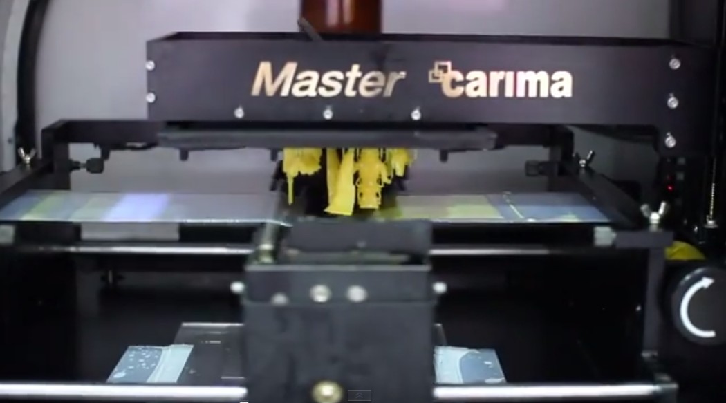

2014-05-05T11:26:07-04:00 2014-05-05T08:29:48-04:00 http://www.buildyourownsla.com/forum/viewtopic.php?t=1437&p=3510#p3510 <![CDATA[Acetat membrane with a resin film recoater, eliminates vat]]>
What are your thoughts on this technology, is it some thing you want to try, advantages/disadvantages?
I'm looking for more information on this separating/coating arm.
Almteq Master Plus 3D Printer - DLP Printing
http://www.almteq.com/nl/gallery/videos/
8:30 min into this video is a clear picture of it.
http://www.youtube.com/watch?v=2MkLD7pY0sA
Carima (I think this is using it)
http://www.youtube.com/watch?v=ow6P-d96f6U
Statistics: Posted by @A2 — Mon May 05, 2014 8:29 am
