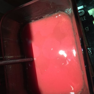

id like to find out why this is occurring. I have had pigment settle with other resins but not float on the surface like this..causing light blockage. Has anyone else had issues with g+ and top down setup?
I thought it was the pigment that had a separation issue..but I bought a container of makerjuice red pigment when i bought this bottle and tried adding some of it to funtodo snow white resin and it mixed in perfectly..hasnt settled since yesterday.

maybe stirr the resin every 10 minutes, to keep the resin and pigment mixed?

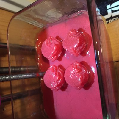

2015-08-27T11:45:37-04:00 2015-08-27T11:45:37-04:00 http://www.buildyourownsla.com/forum/viewtopic.php?t=3827&p=12060#p12060 <![CDATA[problems with maker juice G+]]> so i assume maybe i need to remix the resin..so i remix it extremely well as i did the first time, it seems nice and smooth, no clumps or anything. Do another print of the marvins and it starts to happen again. Its as if the pigment doesnt really mix with the resin, it starts to float to the surface.
I decided to let the resin bottle sit overnight to see if it had excess pigment or something that needed to settle. I cleaned the vat and platform very well and poured resin from the bottle into the vat. It was noticeably lumpy (i hadn't poured any used resin back into this container). at this point I am suspecting that I have a bad batch possibly.. I just tried to do another print and when i came back to the finished print, the vat had that same stuff allover the surface
I have sent a couple messages to maker juice and havent gotten a response yet, but has anyone else had this happen? I have used fun to do and made solid resin and both of them had no issues like this.
